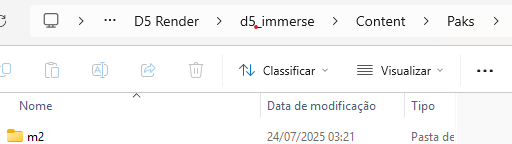

I didn’t find this f2 folder, but m2 folder:
changing m2 name for m3 or something alse didn’t work also.
thanks
Hi @fernando1
The m2 folder is a different folder located at the same address as the paks file. You need to open the .pak files in order to access the f2 folder. Does it still stay m2 even with this path?
