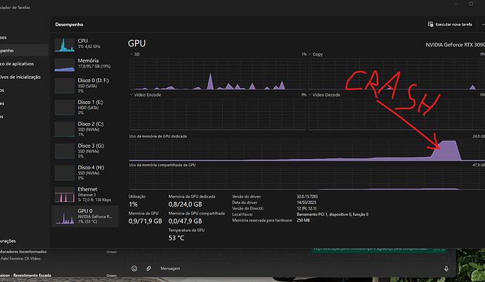

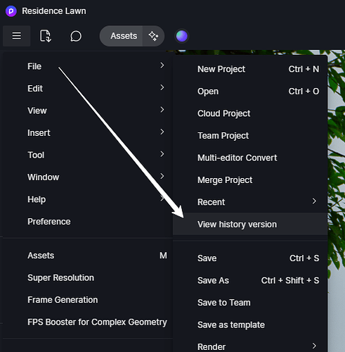

I was preparing a file to render when it suddenly crashed. When I click “view history version” the D5 starts loading, gives a DPU RAM spike and then crashes. I managed to open the backup file by renaming it to .drs, but I can’t save it. I had to cancel a presentation meeting.
the project has a large extension and also large areas of forest scatter (which are visible in almost all scenes)
i7 13700k
RTX 3090 24GB
96GB RAM
