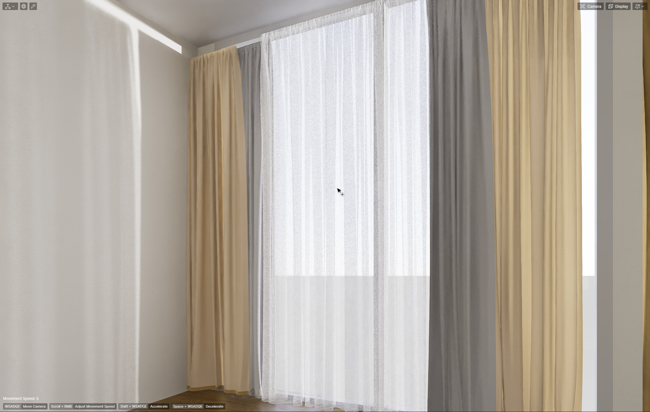

Hello, does anyone know how to get this kind of final linen texture? I have set the “transparancy/ opacity”, and checked the “invisible in raytracing” on cloth section but the final looks doesn’t seem like I wanted. And I didn’t use the assest curtain model from D5 because we can’t setting our own material with them. Please let me know if someone can help with, thank you.

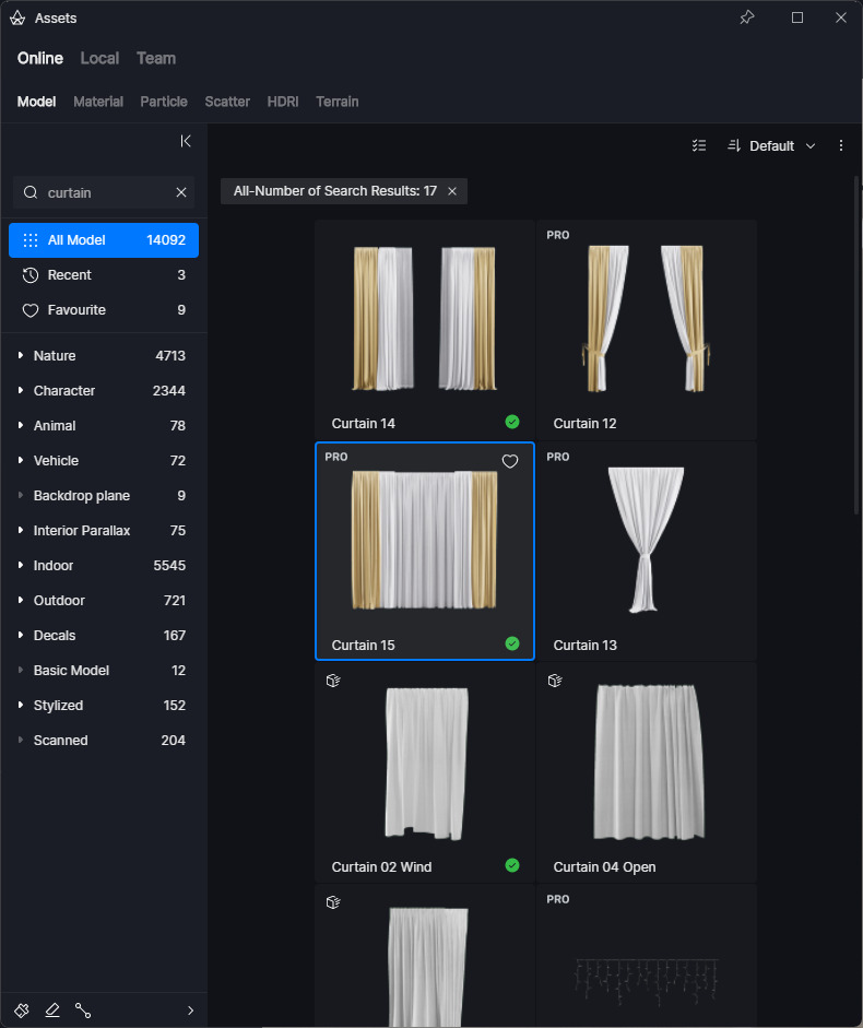

I think this asset from the online library is the closest you’re trying to achieve, minus the material.

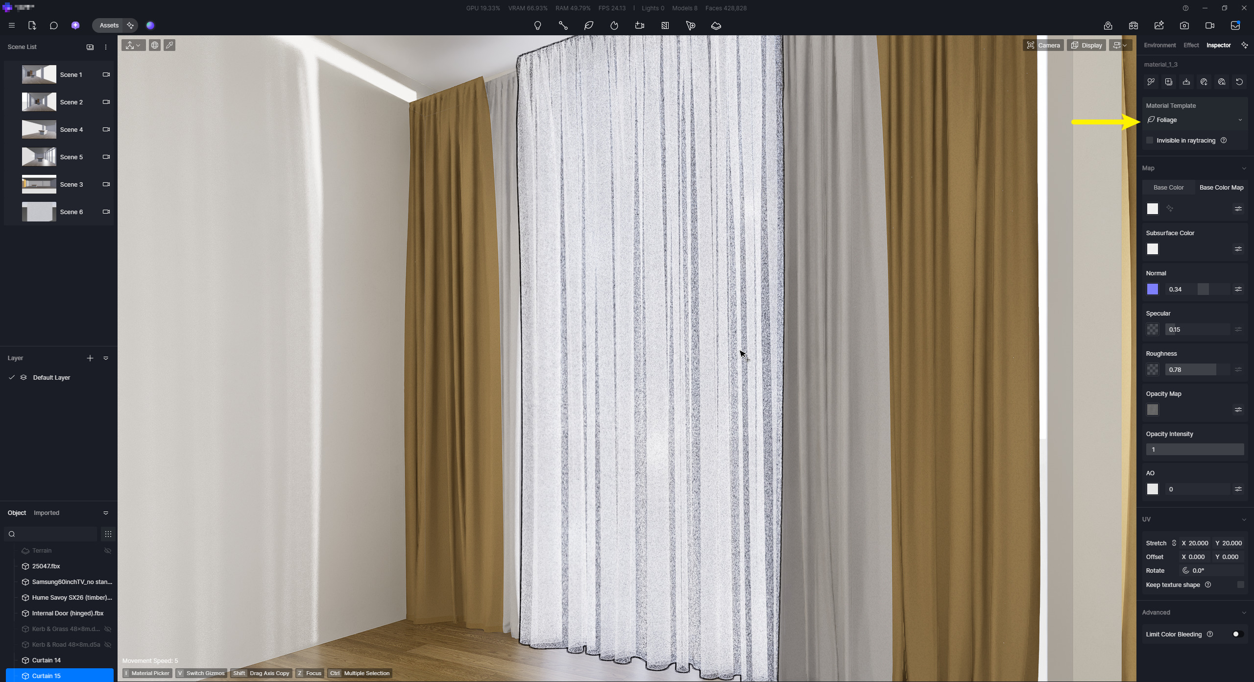

  • You can copy the parameters from this asset (Curtain 15); you can actually edit the materials only on non-dynamic assets for curtains.
  • By default, the material template being set is “Foliage” to maximize the opacity.
Hello, I have tried them and yes it helps but not exact the same as I want but maybe because I haven’t get the right texture material especially for the opacity, but I think It also would be better if we could do the same on the dynamic curtain. Thank you, Clov!
