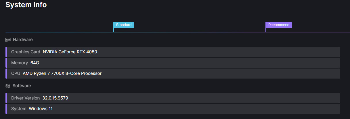

I’ve attached my System Info below.

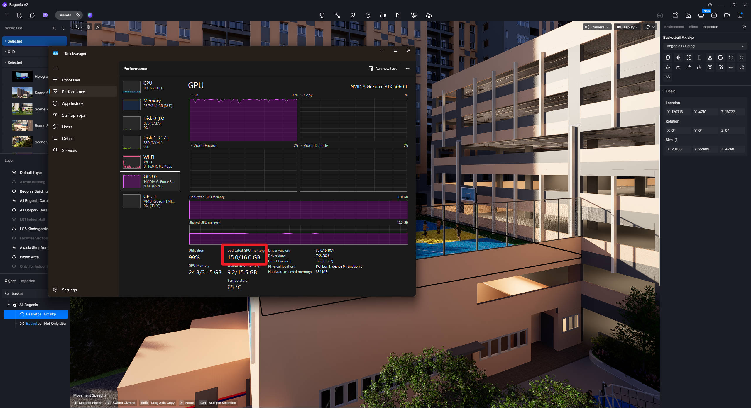

I just tested your file with the 3.1 Hotfix Version. For reference, these are my device specs:
- RTX 5060 Ti
- 32 GB RAM
- NVIDIA Driver 610.74
- Ryzen 9 9900X
- D5 Render 3.1.1.0755
1. Opening the 2 model files
- I’ve tested opening an empty D5 file, then importing the D5A and SKP files, just to check if there are any issues with them. But so far I can open them with no issues.
2. Opening the D5 File
- I’ve proceeded to open your D5 File; it’s not a light file; its size is around 8GB. It’s consuming 15 GB out of 16 GB of my VRAM
- I’ve tried reloading the d5a file and skp file, performance is normal, no crashing.
- Please update to the 3.1 Hotfix Version; there have been improvements with the crashing and lagging since the release of 3.1
- Can you please send me a screenshot of your Task Manager (GPU) while opening these files on your end? Sample Image for GPU below.
- You may do a clean reinstallation of your drivers

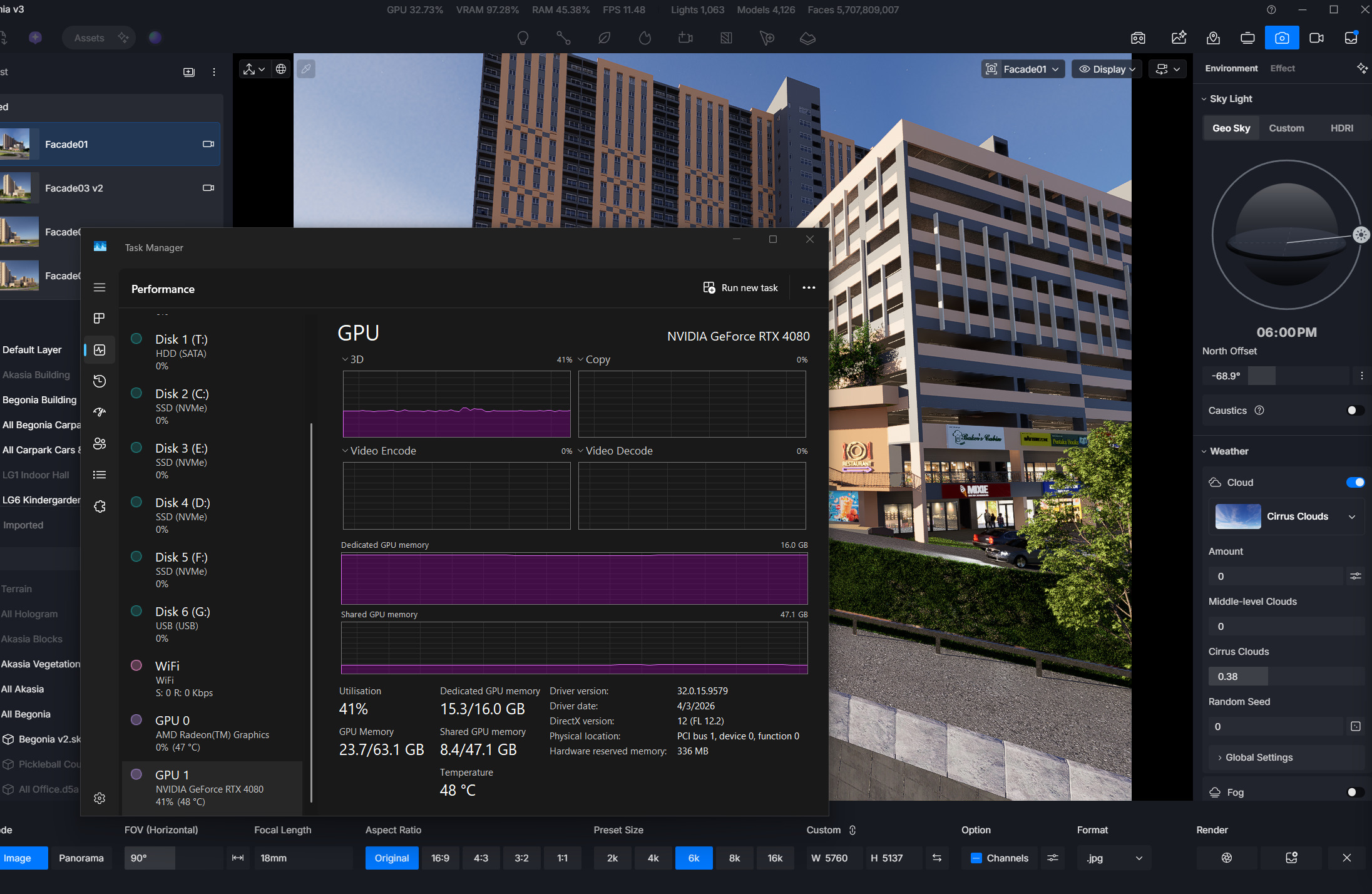

Below is my attachment as requested. I’m now in version 3.1.1.0755. Seems a lot more stable, but at times when work on for hours, and it may still crash out. Perhaps it is because of my GPU ram limitation.
I’ve yet to reinstall the GPU driver. Will try when free. Still rushing to finish up this work.
Hi @newtoncore3
3.1 Hotfix should be more stable compared to the first version of 3.1, so it should minimize crashing and unnecessary GPU overloads. Anyway, try installing it with the latest version specifically, GPU Version 610.74.
