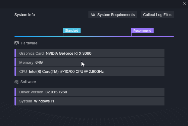

I apologize for the inconvenience. Can you please send me the device information for this particular device?

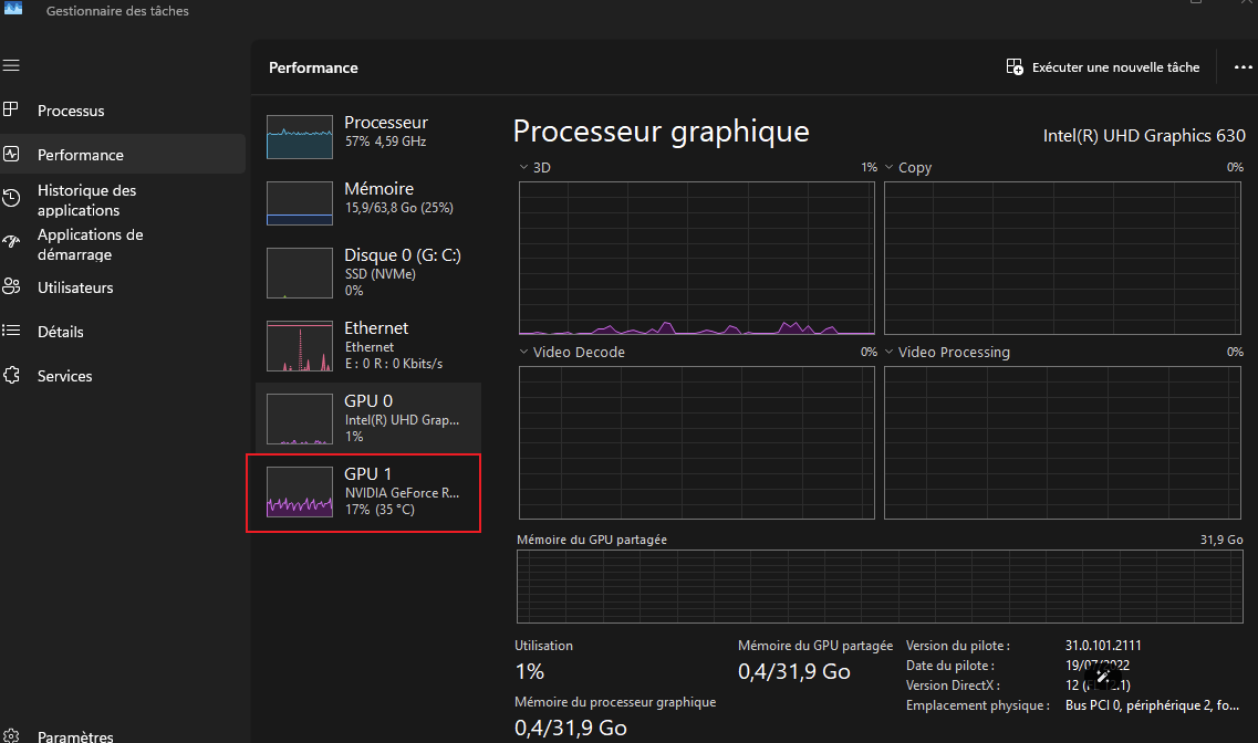

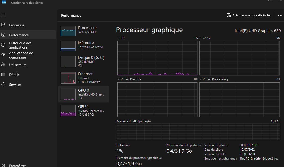

Thanks for this, but can you click GPU 1 (RTX GPU) instead of GPU 0 (while opening the specific d5 file)?

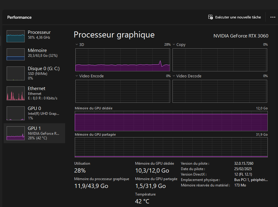

Based on the image you have sent, I don’t think crashing should occur since it is using 10.3/12GB of your VRAM. Usually, if the VRAM is near maxing out, it is usually displayed near 12GB (around 11.4 to 11.6 GB). Unless the version that crashed may have maxed out this portion, which has caused the crash. If you are still experiencing frequent crash for this specific file, let us know; we may need to collect the D5 File.
  • If you have opened your D5 File first then your SKP File then activated the live-sync, it should restore the linkage, but may ask for your permission to either create a new link or replace an existing one.
  • Since you’re still using drivers from February 02, 2025, I suggest updating them to a more updated version.
