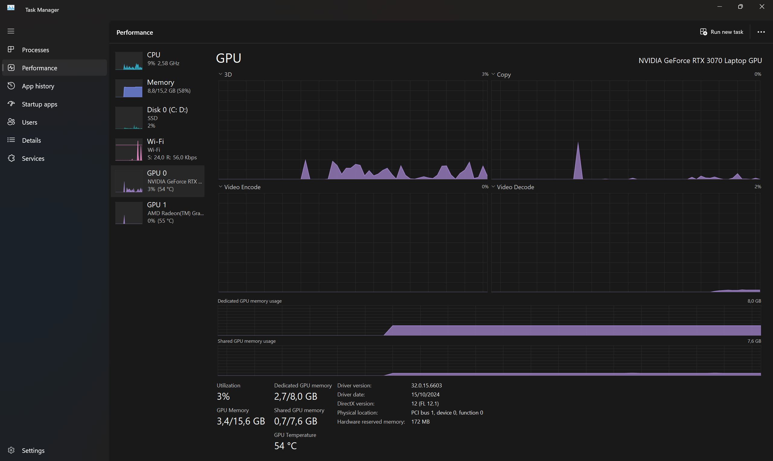

Hi there. I apologize for the inconvenience this issue has caused. Does this problem occur in all other files? Or is it file-specific? Please provide the following information:
Memory Speed
System Information
VRAM
Thank you.

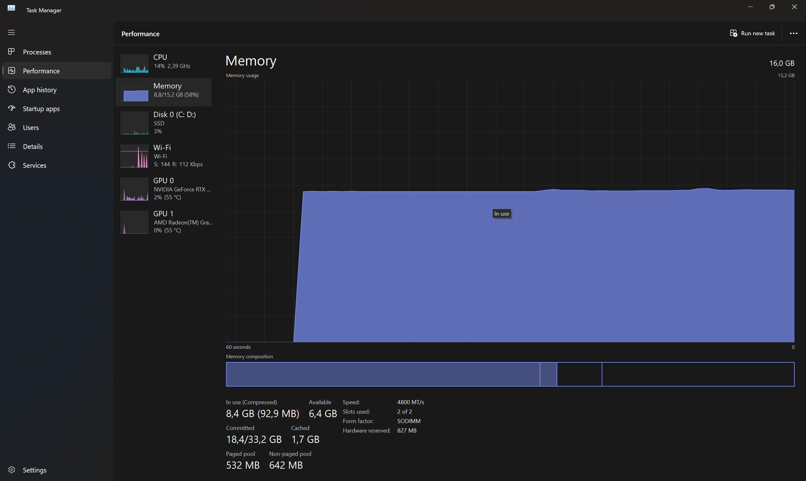

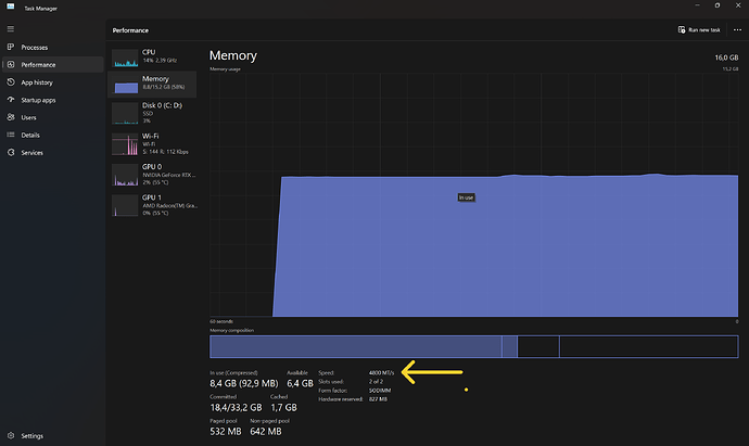

Hi, thank you for providing these images. Your memory speed seems to exceed 4000 Mhz or 4000 Mt/s; anything higher than that would make the software unstable.If you are able to make changes, You can change this in your XMP or BIOS. If you are unfamiliar with the process, you can check out these links: https://www.youtube.com/watch?v=h-MLhGMtheM
https://www.cgdirector.com/how-to-change-ram-speed-in-bios/
