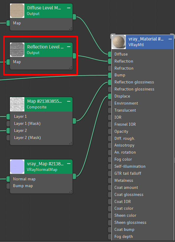

Crash in a specific material while using Vray materials
I found this material after extensive testing.
You can simply avoid using this material, but it causes a crash when purchasing or downloading the model.

Hi @libraryn
Just to clarify, D5 Render currently does not directly support V-Ray materials. When importing a V-Ray material, it may not display or behave correctly in D5 because D5 uses its own material system. To use your scene in D5, you’ll need to reassign or recreate the materials using D5’s native material library.
We’ve also followed up with you via email regarding this matter. Please check your inbox for our response.
