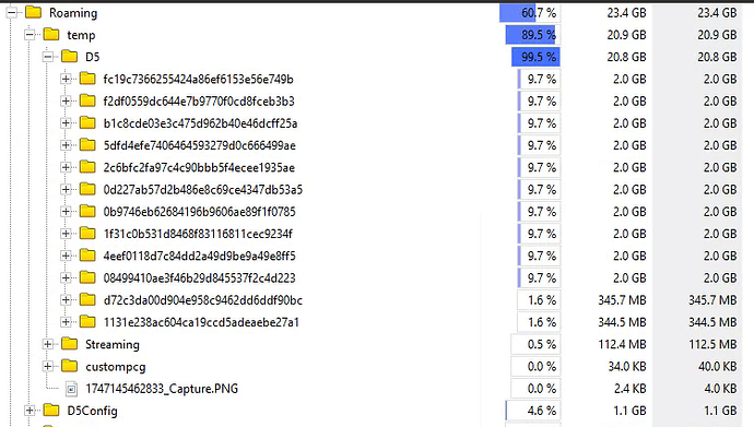

Our firm is currently using VMware, now Omnissa, for our virtual desktop infrastructure (VDI), which relies on roaming profiles. Recently, we’ve been encountering significant disk space issues across our environment.
We’re looking for guidance or configuration to better manage and control temporary file locations within this setup. If you could advise us on how to redirect temp storage to reduce disk usage, it would be greatly appreciated.

Can you please specificy which temp files you’re talking about? Is it perhaps from the Workspace folder or from your D5 File Folders? You can send us a screenshot of these. Thank you.
I have the snip but not the full image - this would be from under user profile appdata
Hi @hryerson
Normally, these files would be removed when launching D5 Render (those files cannot be removed when d5’s working, but can be deleted after quitting d5).
  • Do you perhaps have a hard disk auto backup feature?
  • Can you show us the contents of these files? Just to be sure.
