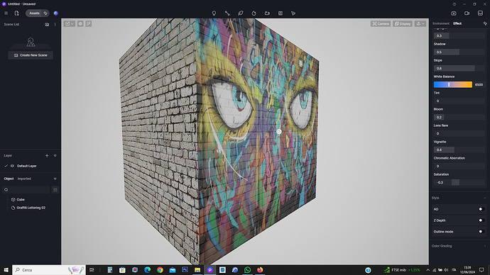

Hi, the question you asked intrigued me. I turned on D5, took a basic shape and gave it the white brick material, then I went to models and in the drop-down menu there was Decals, or I took any graffiti and placed it on the shape where the brick is and this is the result
Then by clicking on the model on the right there is the image of the graffiti, in this case you click on the image of the graffiti that I posted, place your graffiti, you can give it any scale to fit the size of the wall and then give it a bit of transparency To show the wall mapping, place the image as it would appear
I hope I helped you, good work

Hi again, you’ve understood the mechanism, now with these graffiti of footballers you just have to place them on the brick wall, that is, if you have the image of these footballers you have to put them on the wall with the brick mapping already so you won’t have a false mapping of the brick, or if you don’t like this you create it with the graphics program you use and synchronize it. I’ll give you an example of what I’ve done before when there was no way to do it.
Look at the image of this rock entrance, it is a PIG image with the transparent base made with Photoshop, imported into the graphics program and I gave it the scale of the image on a panel, as if it were a large tile, you have to do this if you don’t like the other solution.
Or you can do it this way to have intensity of the graffiti with the bricks, copy the roughness of the brick and AO of the brick, insert them by pasting into the model and the opacity to the maximum. this is the result
To adjust the intensity you need to move the graffiti model closer or further away.
