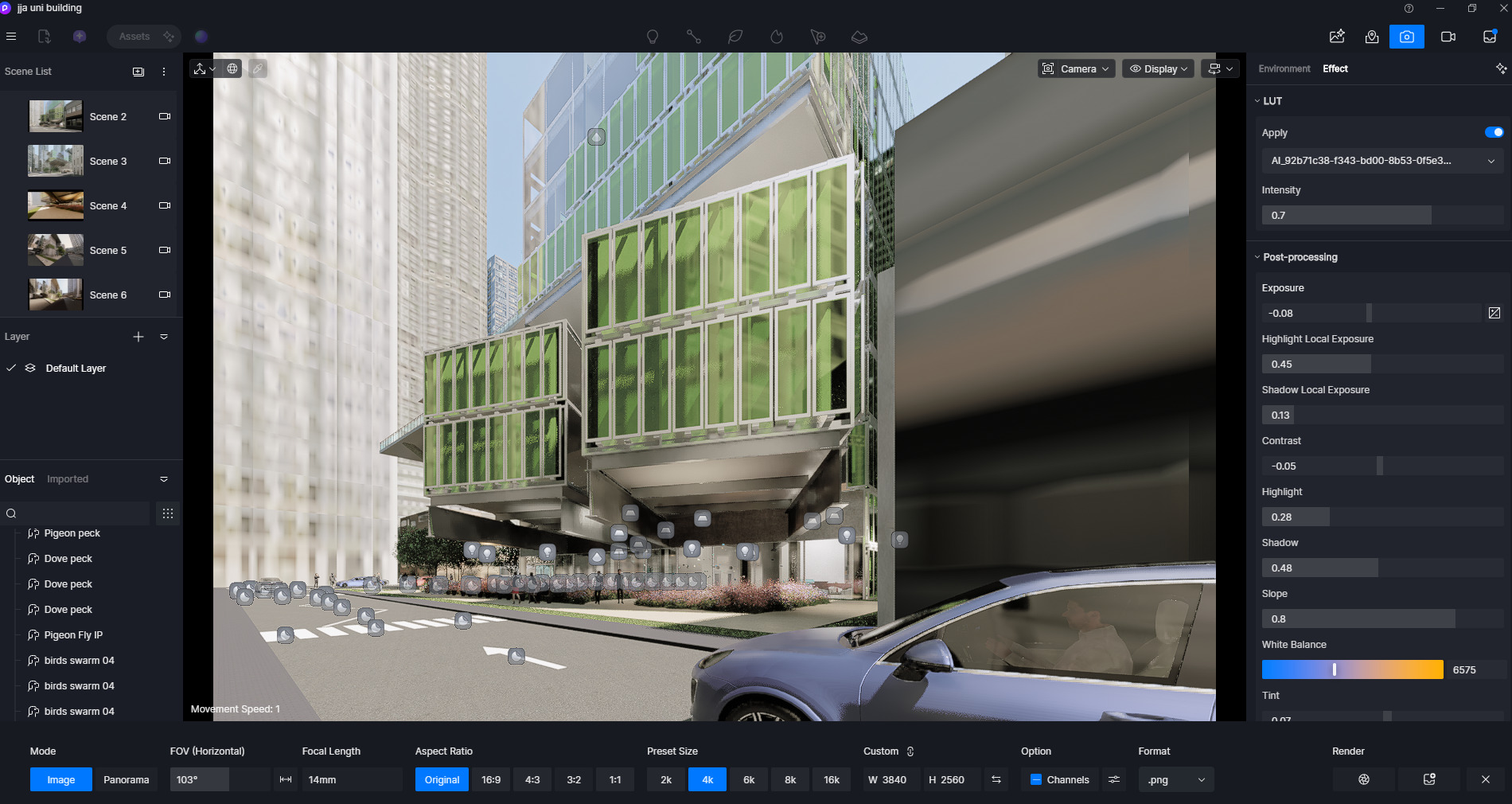

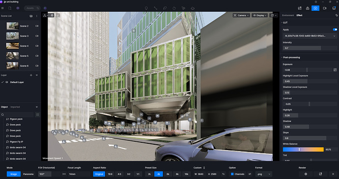

Context buildings being blurry after re opening d5
Hi, my conctext buildings seem to be blurry and not sure why. this only happened when i reopened the file. the surrounding conctext is from importingg it using d5 and then styilizing it. when i rendered it earlier it was fine but now im unsure whats going on.
P.S I asked ai why this happen it suggested to turn of d5 sr which i did which only fixed the problem when i reloaded the file but then i added an asset and turned all the surrounding buuildings blurry.
I tried making a new file with the context buildings in. the context building was fine in th enew file until i merged files then it became blurry again.

  • This building model is an imported model, right? What’s the texture size that’s being used?
  • How did you stylize this model in D5?
  • Which D5 Render Version are you using? Is this 3.0.1.0683?
There are multiple possibilities for why this is happening:
  • D5 Client limits the size of the imported textures; if it exceeds 4k, it will be compressed. His texture is 15000*15000; after compression, the pixel details are lost.
  • Try modifying the camera clipping plane to 15500
If the issue still persists, please send us the ff:
