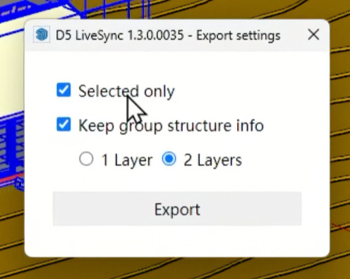

Yes, D5 Sync for C4D has not supported Group Export feature like SketchUp’s. We may support it in subsequent releases. Thank you.
D5 Team
This is very important feature to have C4D layer structure inside D5 like in Sketchup Sync
Currently there is no way to export different parts of model for D5 maquette animation
