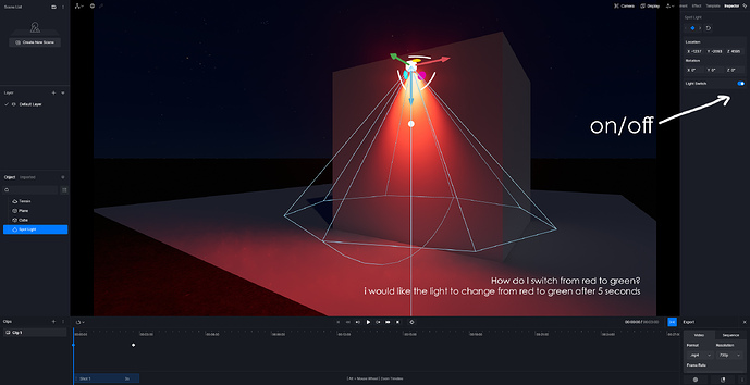

Good morning, I have a problem. I need to change the color in an animation, the lights go from red to green. How can I do this? It seems that I can only turn the light on or off, but I can’t change the color.

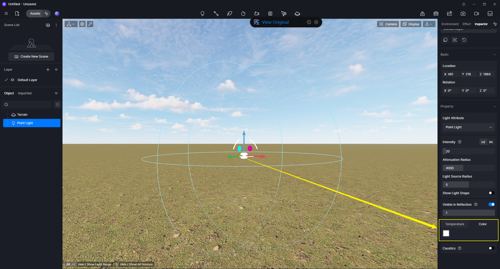

Did you perhaps change the colour of these lights intentionally? Can you send us a video recording or a screenshot?
- The light colour can be changed by selecting the light > colour
Thank you, but during the animation, that color setting disappear. I need to change the color of the light during an animation video
As far as I know you can’t animate the light color … you can keyframe on and off but not the light intensity or color… Maybe it’ll be implemented later on.
Hi @grafica
Indeed, @s.bernard is right, keyframes has yet to support changes in light intensity and color. We may support this in subsequent release.
