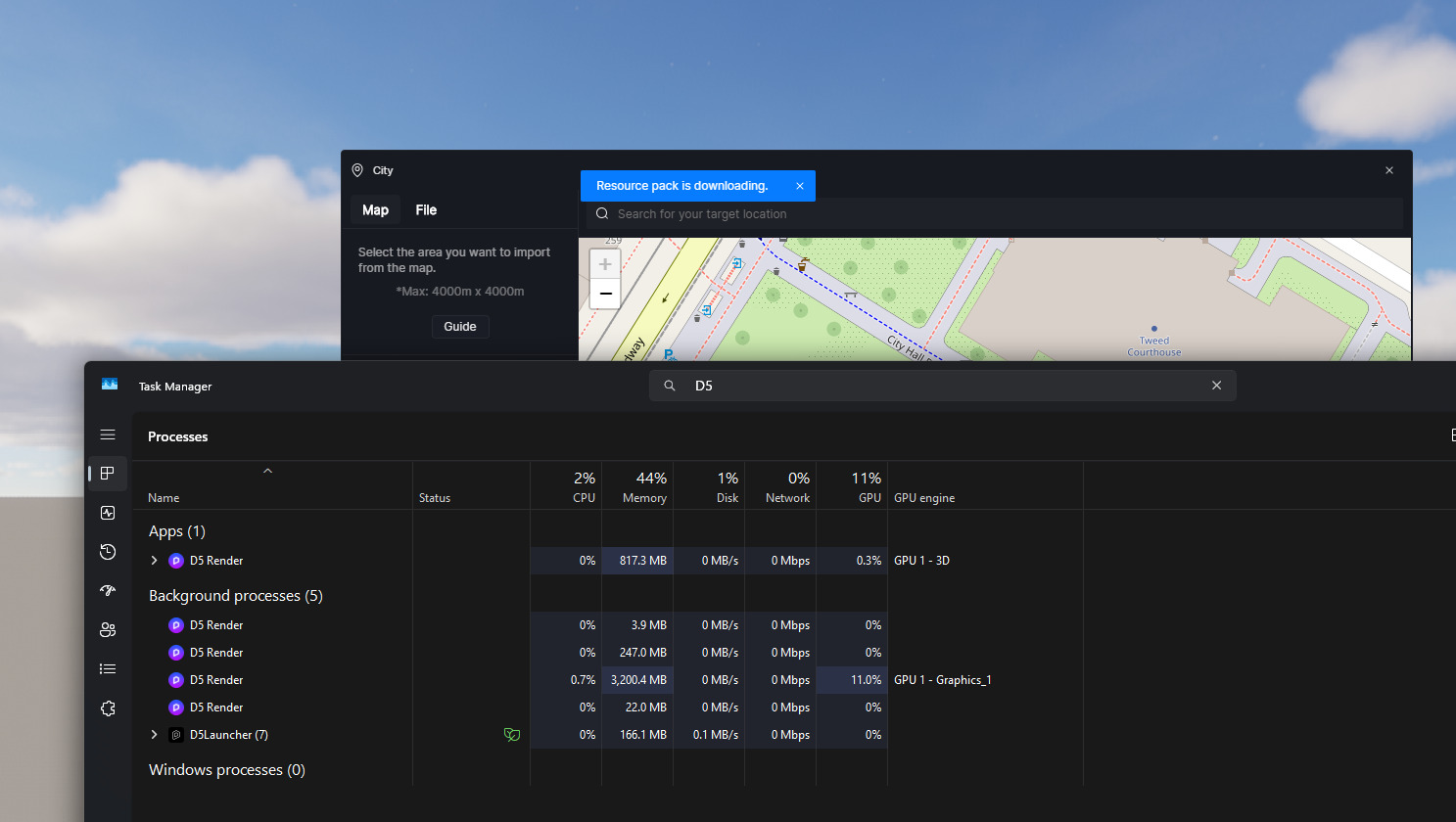

Facing issue since D5 Render 3.0 now even with latest hot fix update. I am unable to use city generator now. It just says “Resource pack is downloading” but it does not actually download, as you can see from task manager. Stays like this forever, making different selections, changing locations, or changing import filters has no effect.
There is no bandwidth activity. Which means it’s not actually downloading anything at all.

I have tried all the steps suggested. These are the results:
  1. The network test ran fine without any error and showed the correct expected speeds.
  2. I have checked, there is no firewall or anything blocking D5Render. In fact all other assets and materials download without any issue. It’s only the City Generator which is not downloading resources at all. I have kept it active for half an hour, the message does not go away. There is no network activity
  3. I have repeated all steps with my mobile hotspot. I have tried 3 different ISP at 3 different physical locations.
Like I said, everything else that requires connectivity works fine. Materials, Assets, AI tools all work online without issue. I am also able to sign in without issue. It is only and specifically the City Generator which is not working. Keeps showing the resource download message. I really don’t want to uninstall and risk losing my settings and presets. When the City Generator was first introduced it worked fine. But during recent updates, it has stopped working altogether.

Still having issues with City Generator tried all suggest trouble shooting. Is there a better way to debug? I cannot even get Cesium to work after adding my token. It just says ‘Resource pack is downloading’. and I get nothing else. No internet traffic, so it’s not actually downloading anything at all. All the other online features work fine like downloading assets or creating tours.
