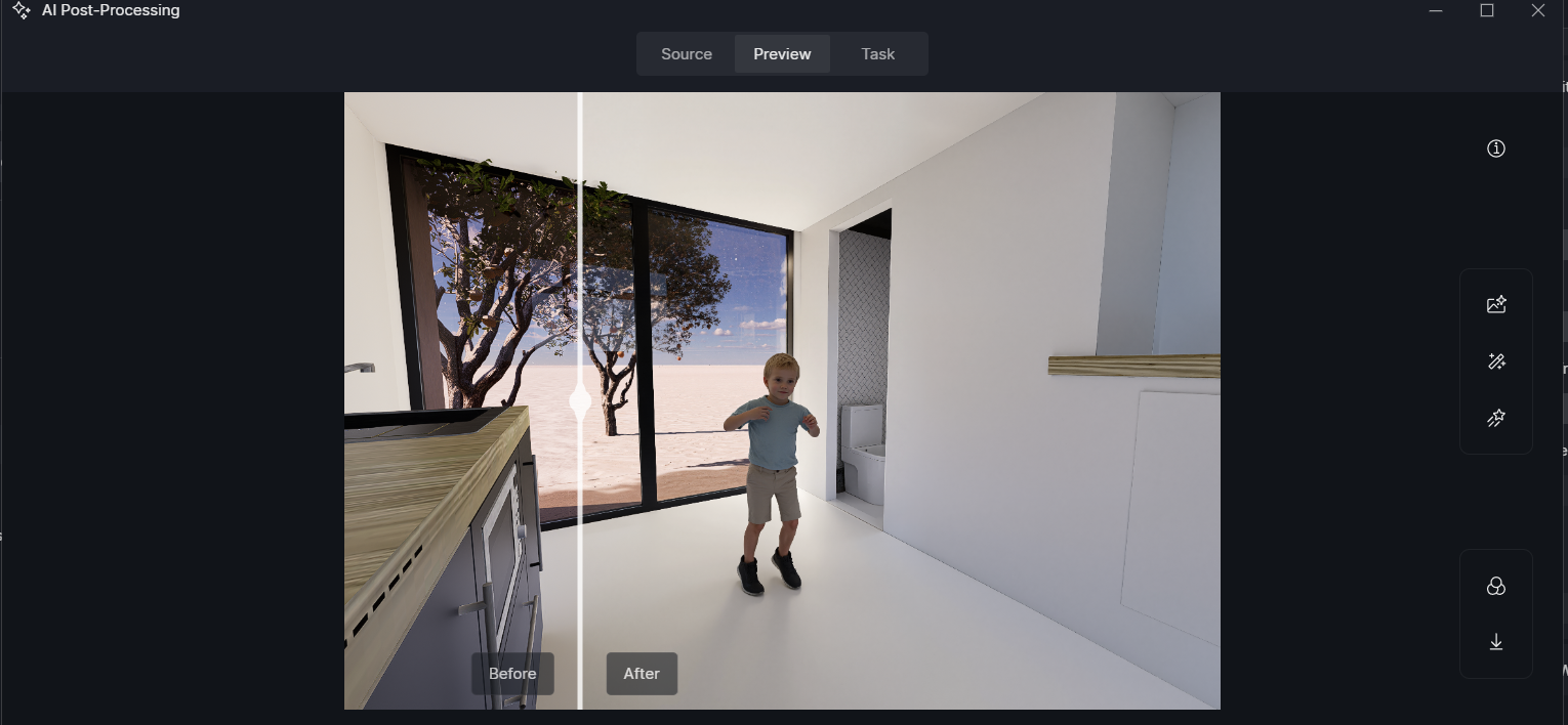

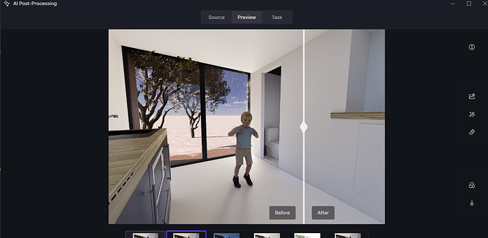

Hello @ela, thank you for your answer. Please find some illustrative screenshots.
Hi @espacesetprojets

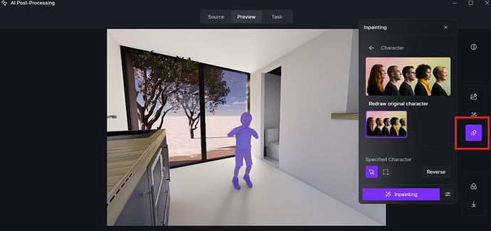

Apologies, this is a known issue with AI enhancement affecting character. Please rest assured that we’re taking note of this and will use it as feedback for future improvements.

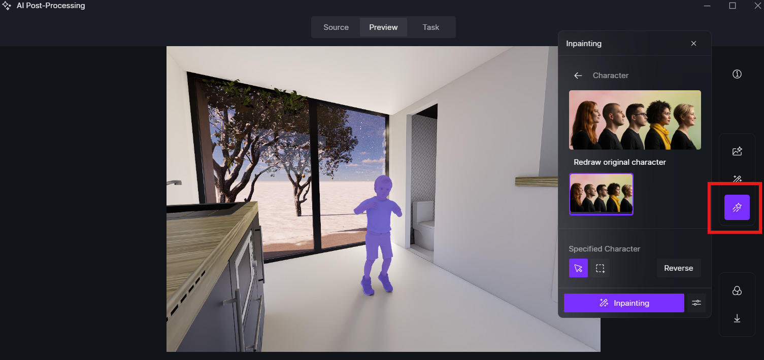

In the meantime, you can try using “Redraw Original Character” in Inpainting. This will help keep the people closer to the original input image.
Let me know if it works for you. Thanks :blush:
