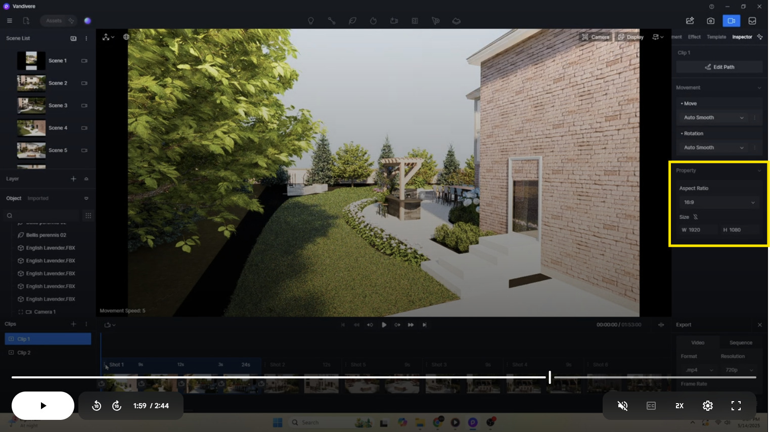

I guess to clarify, I have a video already set up in the standard aspect ratio. But I need to change the aspect ratio, rather than just completely redoing the video setup from scratch with a new camera.

Thanks for providing the video. Upon review, isn’t this the option that you were trying to find? :thinking:
  • You can click Clip 1, then the aspect ratio will appear. Currently, the aspect ratio changes will be applied to all of the shots inside the Clip. You can check the video recording - VideoTest aspect ratio
That was it!
I knew it was something simple that I was missing
I guess it makes more sense to be on the whole clip rather than individual shots
Thank you
