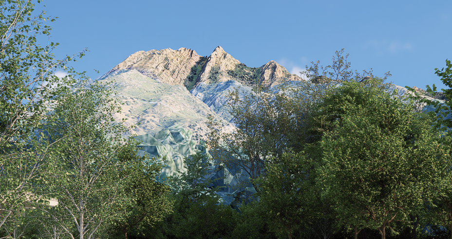

I am struggling to figure out why there is a distinct line across the mountains where cesium fades out. Does anyone know what may be causing this?
Hi @bcross
  • Just to confirm, are you using version 3.1 or 3.0.1?
  • Is this Cesium or D5’s Terrain? This seems like a feature from D5’s Terrain.
  • If you try to move closer to this portion, does the boundary disappear?
Please try the following:
  • Try to change your environment settings, perhaps from HDRI to Custom (or vice versa)
  • Enable Compatibility with old atmospheric perspective mode.

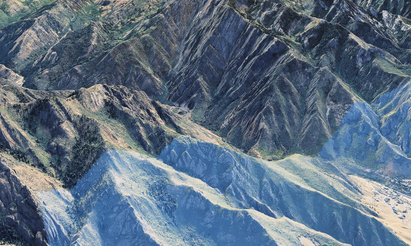

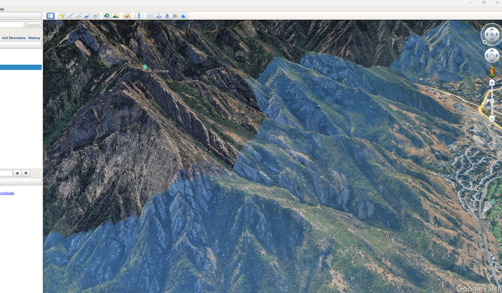

After further investigation it appears to be something on google earths side. Thanks for your response.
