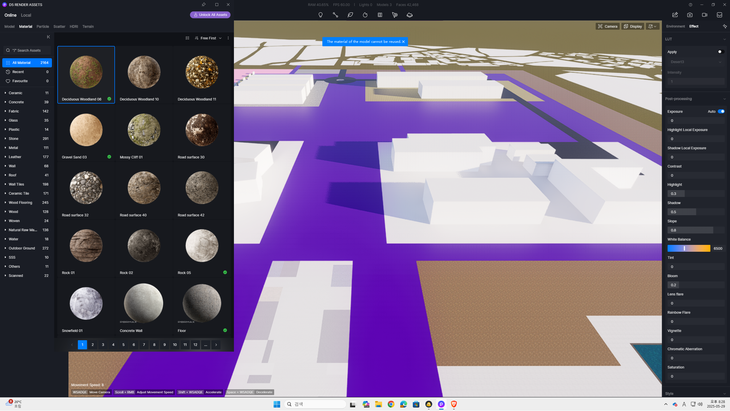

cant select texture and cant put assets my friend can put assets hes sketchup version is 2023 mine 2025 its sketchup issues? or my d5 error
Hi @msad241
The error prompt “The material of the model cannot be reused” appears for various of reasons but based on the image you have sent it may be caused by:
- The model being too far away from the origin - please check the XYZ values in D5 Render and change the values to 0,0, and see if it resolves the issue.
already 0,0,0 sir
try explode group in sketchup and make a new group
            didnt make group
Hi @msad241
If this issue is related to the new posts that you made. Please check the unit from SketchUp; if you’re using meters, then inputting sizes with 100,000 meters or more might be too large. Or simply the scale of the model is not correct, please try to rescale it or match the units, then try to put a material.
- If it does not work, you may send us your file, you can send it to me via Direct Message here.
