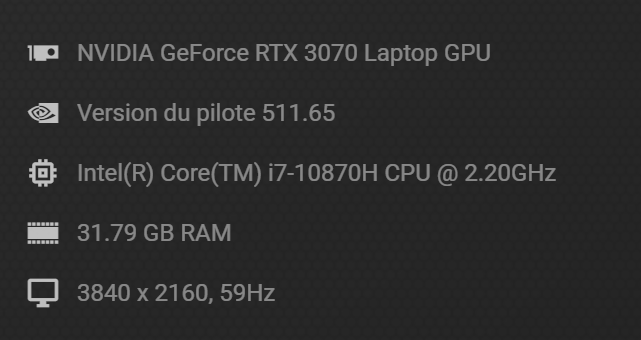

i tried on two computers, i have two pro licences, one lifetime one monthly, same issue

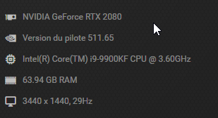

Hello, could you please let us know your hardware specs? If you can render a single photo, but cannot render multiple photos at one time, I think maybe the GPU is not enough, or the temperature is too high, especially when you mentioned you had met the TDR error.

here are my specs:
