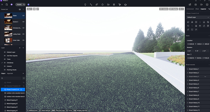

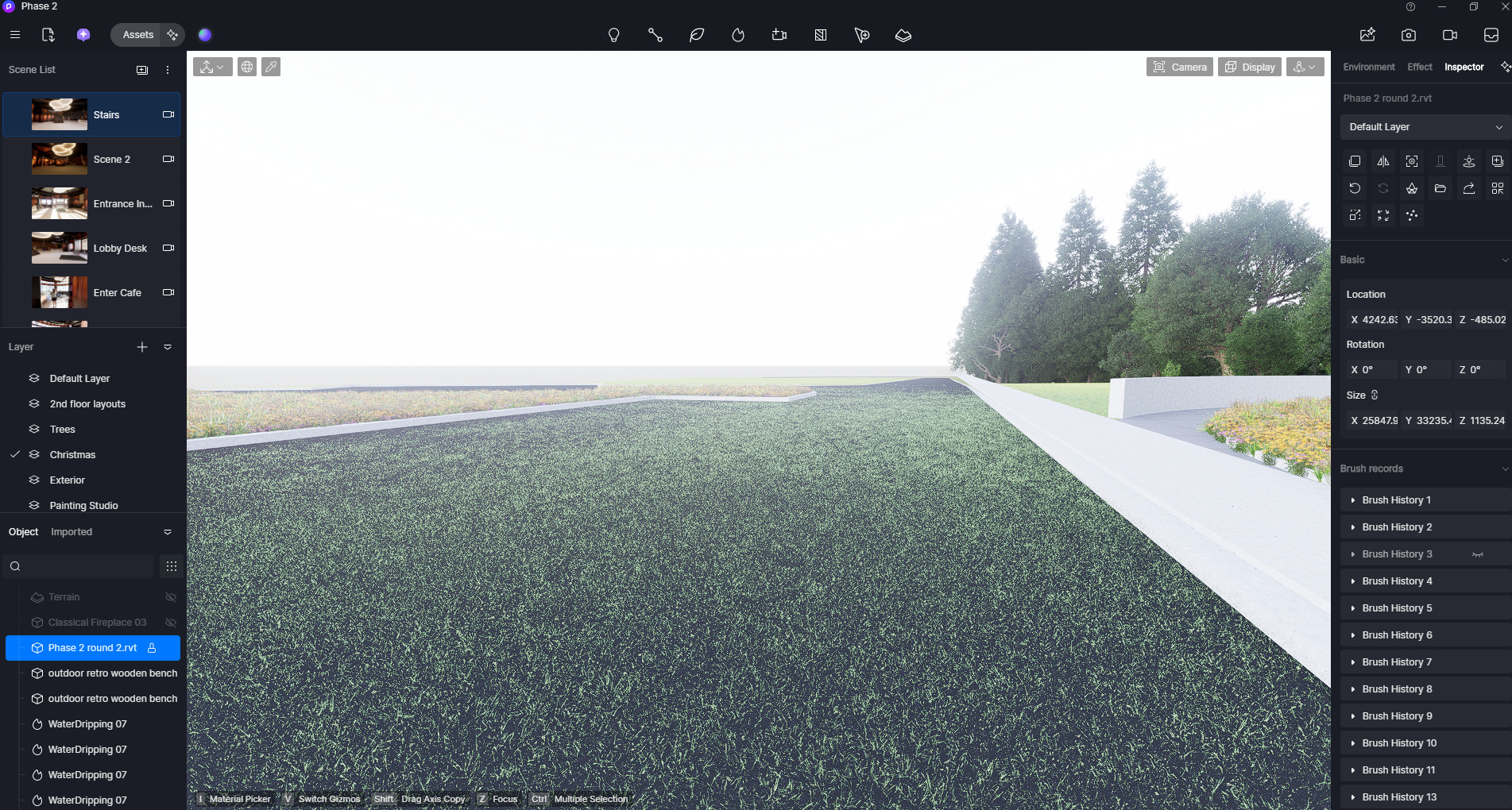

I can not erase this grass. It is not in my brush history, it is not labeled as a scatter. I don’t know how to remove it. Please help

Could you please double-check if a grass material or texture was applied in your Revit model before syncing or importing it into D5? Sometimes grass appears because the surface was assigned a grass-type material in Revit or because a D5 material was auto-matched.
Please try selecting the plane where the grass appears and see if anything shows up in the Inspector panel in D5. If the Inspector does not show any grass properties, then the surface is likely using a material from Revit.
To fix this, please reassign a basic material (e.g., a default solid color) to that surface in Revit, then reload or resync the model with D5. This should remove the grass effect. Thanks :blush:
I had to restart Revit and D5 to get it to sync correctly after doing that to get it to work. Thank you!
