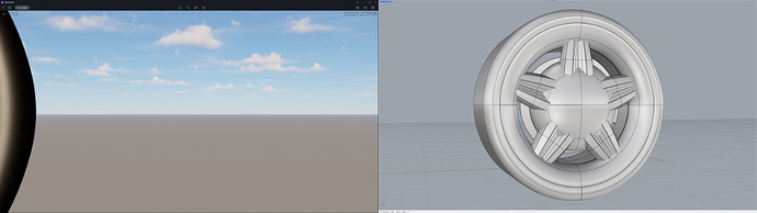

Whenever I adjust the view frame in Rhino with commands like Zoom Extents or Zoom Selected the camera in D5 looks at a point of its own choosing. I.e. the camera target coordinates are not synced properly from Rhino. Rotating or panning of the view frame is synced after that, the view is just shifted in D5.
For some reason it seems the camera in D5 is more interested in the 0,0,0 point.
See below:
Cheers

Did you “update the model and materials” before adjusting the views in the D5 converter? Now we need to do that step after moving the model in the modeling software. But we will have real-time synchronization probably at the next versions.
Hello Bruce
I must have done something with the scene in the drs-project. When I delete it and connect my Rhino file to a newly created one everything works as expected.
My apology for this false alarm.
Cheers
