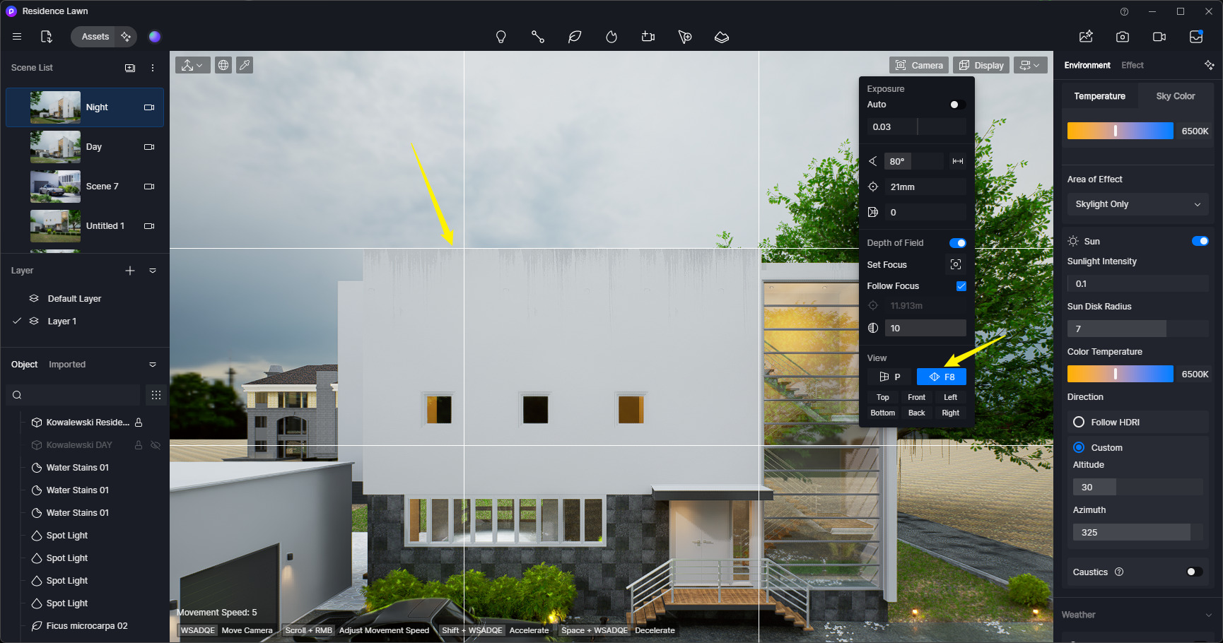

There seems to be an issue in the camera settings. Even though all angles are set to 0°, the image is visibly tilted. This is because the angle settings only allow whole numbers. No decimal places (for example, 0.1°).
I can manually adjust the camera so that it’s straight and save this adjustment. But when I select the view again, it’s adjusted again. It tilts again.
In the image, you can see that the ceiling line and floor line on the right are tilting downward even though the camera is perfectly perpendicular to the wall.

Hi @Albareus
Try switching to Two-Point Perspective and enabling Grid. It will have a better alignment.

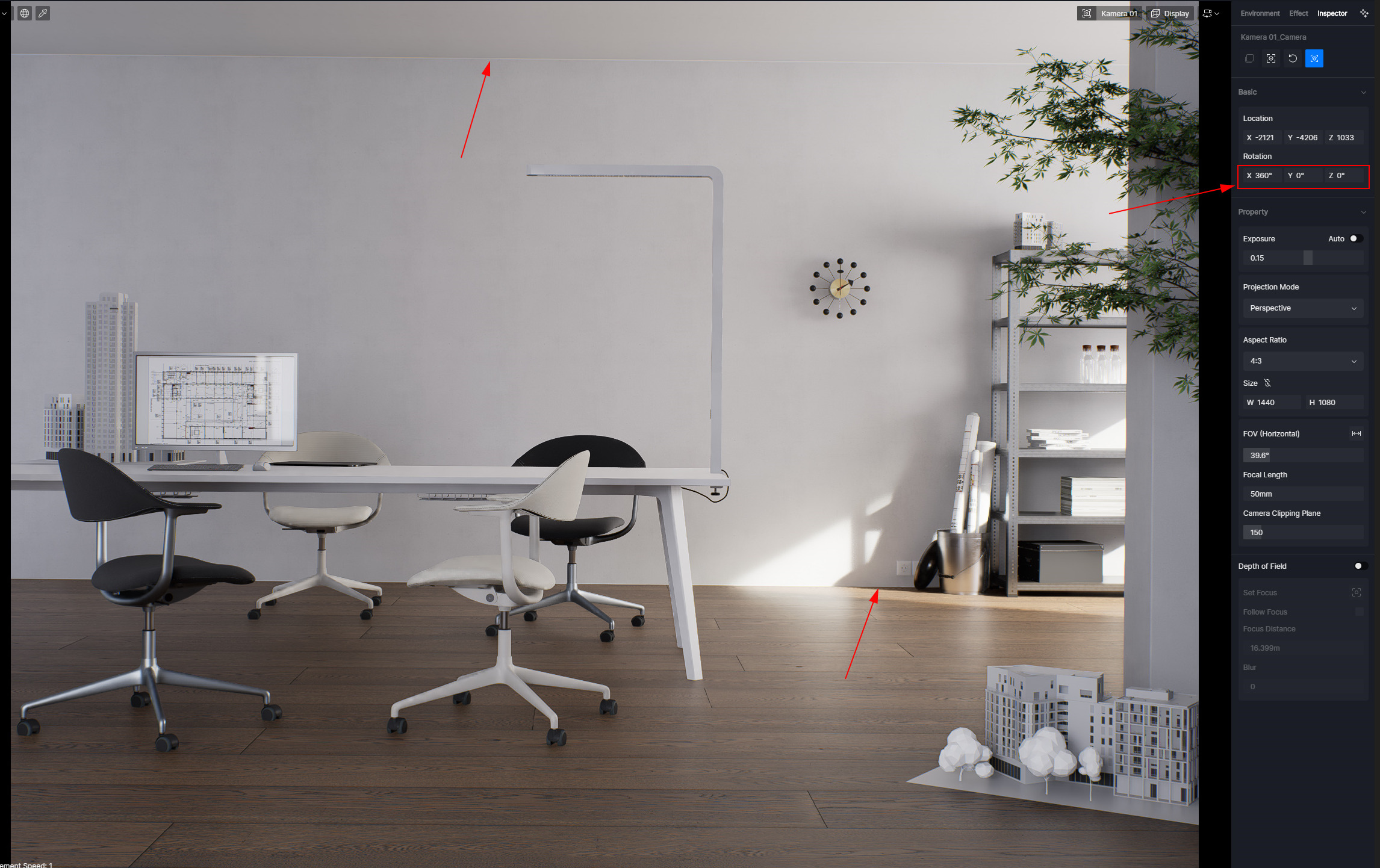

Hi @Clov
Thanks for your reply. Switching to “Two-Point Perspective” only changes the vertical lines. The camera still remains tilted horizontally. This is because the camera settings don’t accept angles with decimal places. This should be implemented in the program.

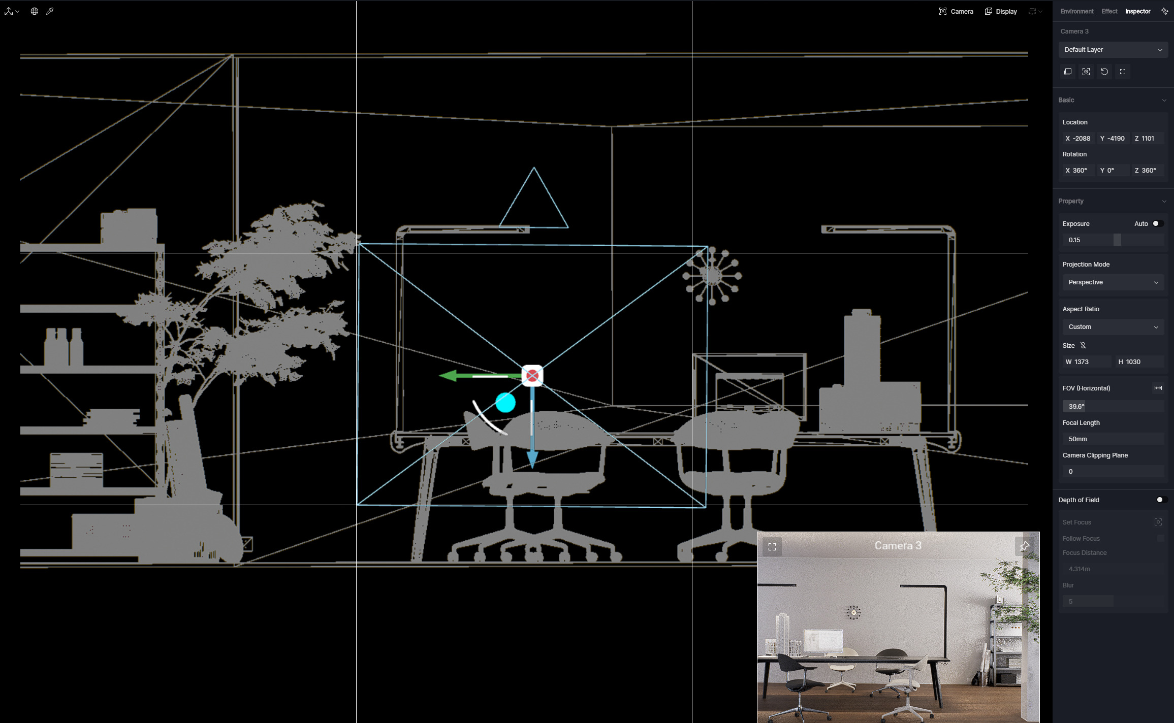

I made a copy of the camera via “File > Insert > Current Camera!” Here you can clearly see in the side view that the camera is tilted even though it is set to zero (or 360°) in the settings on the right under “Rotation”.
