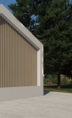

Hi! This is the first time something happens to any of my projects. Everything is ok but some edges that get non-uniform highlighted when it shouldn’t even get any highlight.
I tried rotating HDRI, sun, using another HDRI, using Geo and Sky, getting up and down lights values, but theres always some edge that get this problem.
Anyone knows why this could be happening?

Is this only evident on this specific file? Perhaps, did you check if there is a material inside that has an emissive value?
I have solved it a couple of minutes ago. The problem was the local shadow and highlight exposure. Above certain values—around 0.15–0.2—those light artifacts would appear. After adjusting every parameter in the Effects window, I confirmed that those were the only settings causing the issue. It’s also true that this is the first time I’ve encountered anything like this; I suppose it’s due to the specific characteristics of the HDRI I’m using, and so on.

Thanks for updating us. Are you perhaps using a custom HDRI? Or a default d5 HDRI?
I’m using this preset from D5 Studio Compilation, with a couple tweaks on the global luminosity and exposure.
