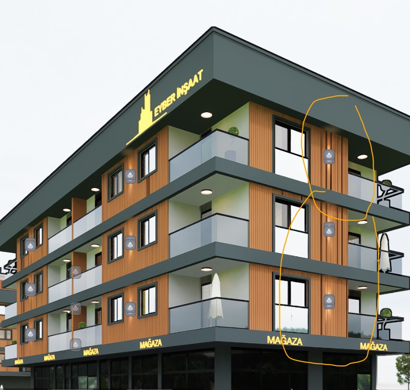

Bu modelde bozulmalar oluyor
Bu modelde bazı yerlerde sorunlar oluşuyor sebebi nedir. modelleme dosyamda sıkıntı yok ama render benim modelimi bozuyor
Hi @mimaraysegulozen
  • May I know which 3d Modelling software was used? Can you please check if the model is near the origin? There’s a possibility that this may be causing the issue.
  • As for the XYZ values in D5 Render, you may also select the model in the objects list and check if they are too far from the origin. If they are, please modify the values.
  • You may also try to disable Super Resolution or FPS Booster and see if the issue persists.
  • Updating your Graphics Driver may also help, but please avoid the 576.02 Version.
