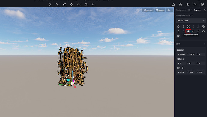

If the plant is placed separately, then you can replace it.
You can also use the path tool to draw plants that can be directly replaced with other plants from the library.
