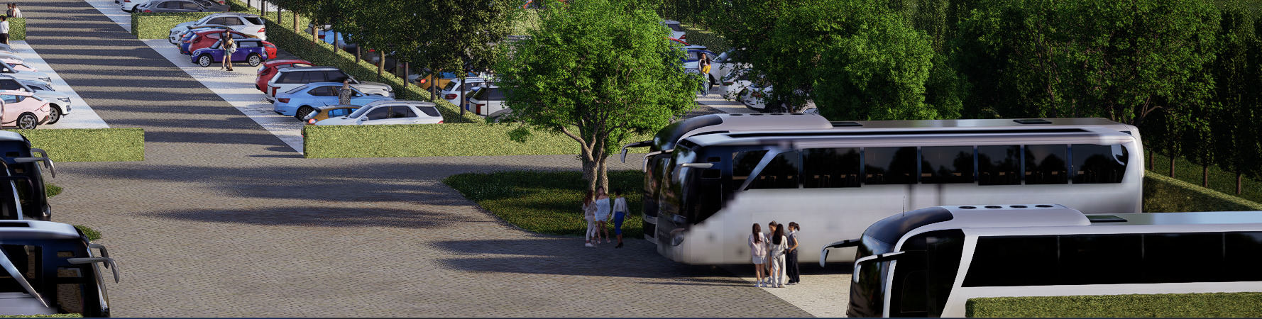

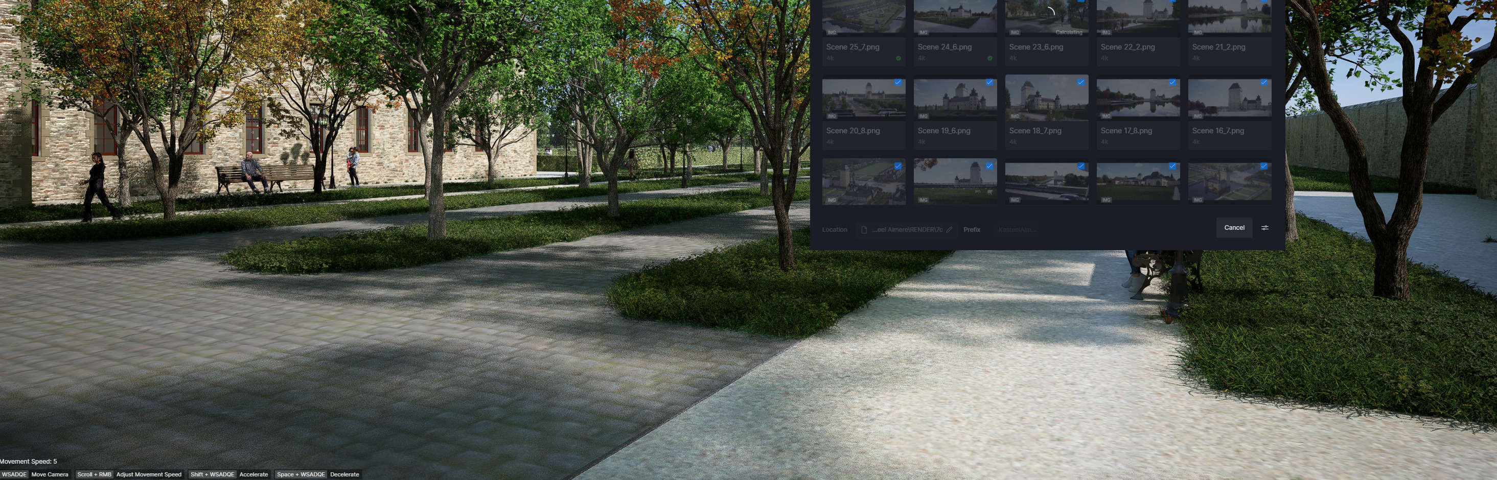

Blurry textures also with render
Why do i get Blurry textures. when before working on the model all was fine.
why is this hapening. not only one model not only one texture.
i still use 2.10.2
models are SKP

On discord they said. Wait a bit. Big files need longer loading time. I did. And that worked
90 billion faces incl 8k texture…
All the files are skp. And i reload them.
I do not use the plugin or do use live sync.
Alright. Some of these textures may need time to load completely in D5, especially when using high-quality textures + a heavy file with a lot of faces.
Anyway, this issue has been resolved according to what you have said.
