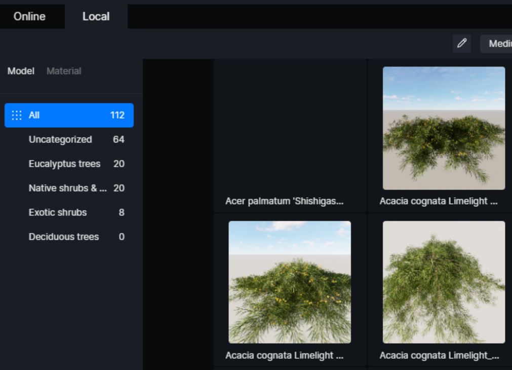

I have been uploading my own plant models to the local asset library without any problems until today.
Suddenly the thumbnail only shows black, I have tried different models but am having the same outcome.
Have tried closing D5, restarting the computer etc but the problem persists.
Please see screenshot attached.
Any help would be very much appreciated!
Thank you in advance :slight_smile:
Hi mate, I reproduced the issue. It seems it is because the name contains " ’ " character.
Please rename the model then add to local again and check the result.
I have shared this issue with our dev team, we will look into it, thanks!
