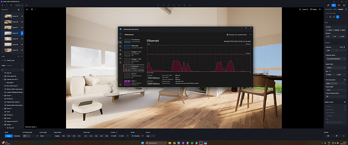

Big internet slowdowns when I open D5
My internet connection is completely slowed down (almost paralyzed) as soon as I open D5 Render.
I’m working on a Lenovo laptop and have a fiber optic cable connection.
When I close D5, my connection is fast again.
Is anyone experiencing this problem?
Is there a solution?
Thanks in advance !

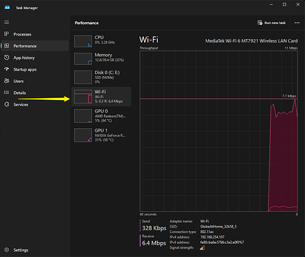

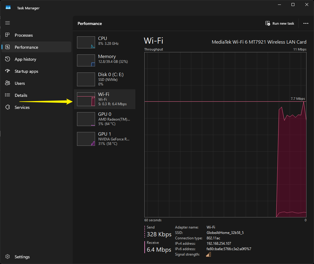

Does this issue only occur on your device? Have you tried testing other devices using D5 Render to see if it has the same issue?
Please send us the following:

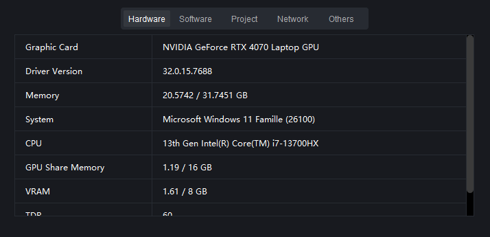

Please send me your log files. The image guide is on the previous image I sent. You need to click “Collect Logs”, they’re zip files, not image files. Thank you.
Here we go, sorry for the misunderstanding.
https://www.dropbox.com/scl/fi/9nqg65k9mkv13au2q1oqk/zziplog.zip?rlkey=2h8vyu82i8jnjjmqfkqbai5bn&dl=0
Hi @perriardbastian
Thank you.
We’ll be examining your logs, I’ll get back to you as soon as possible.

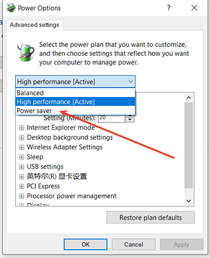

Our team have inspected your logs and wants to confirm the following:
  • Are you using Power Saver Mode?

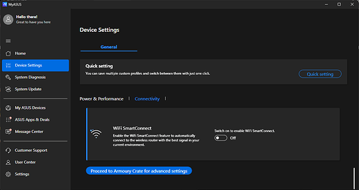

  • Are you perhaps using a Laptop? Did you happen to enable any network boosting settings by chance? If so, try to disable them. (e.g. Lenovo - Network Boost in Lenovo Vantage , or MyAsus - Wifi Smart Connect)
