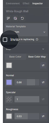

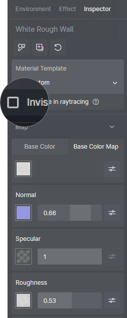

Select the curved material and check “invisible in raytracing” in the parameters panel to give it a try

it didnt work as what I intended. the background image still blocks sunlight
I just did an experiment with basic model arc from d5 engine, it worked fine as u said. My problem was that the arc is actually model from sketchup, so even with invisible for ray tracing being toggled off it still didnt change anything.
I wonder if this is a thing that model from skethup will always block sunlight
Oh! I’m sorry, I only know that this model is coming to SU now, you can save this model as a SU file separately, and then import it into D5.And than,check “invisible in raytracing”。
