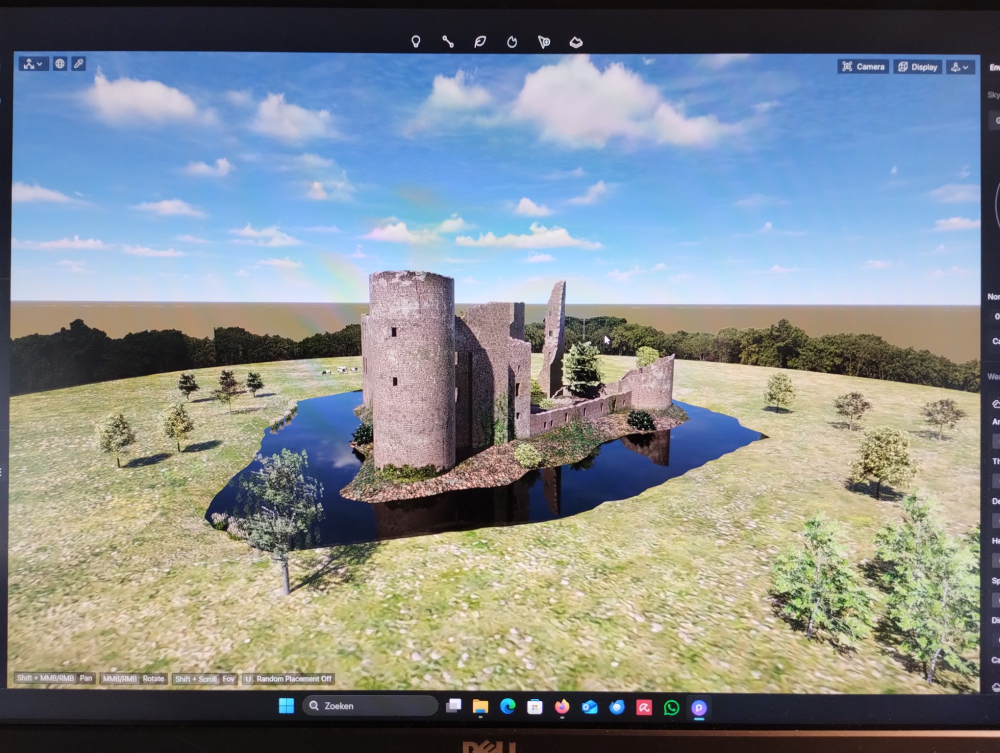

I recently started using the free version of D5 and am enthusiastic about the possibilities. I imported a Sketchup design of a ruin into D5. What can I do to make the background realistic to the horizon instead of a brown plane?

Can indeed perform some actions but within a marked frame of the terrain. There is still a strip left on the horizon that I can do nothing with. I want a flat simple landscape in low resolution around my ruin design. Are these standard downloadable?
The editable terrain spans 4000m x 4000m, hence the white boundary that is evident. Try to change your model’s location near the origin.
