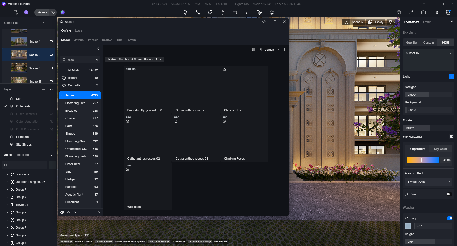

My D5 not loading asset browser even my network is stable. Having speed of around 90mbps. Switching to other ISP (JIO), will load icons but again it takes too much time to download. Had this issue before, when everything take too much time to download. But switching to different ISP from JIO, everything worked smoothly.
But again i am having this problem from 3-4 days.
Also i think my d5 render forum is also loading slow. Can’t able to load attached images. and logged out automatically.

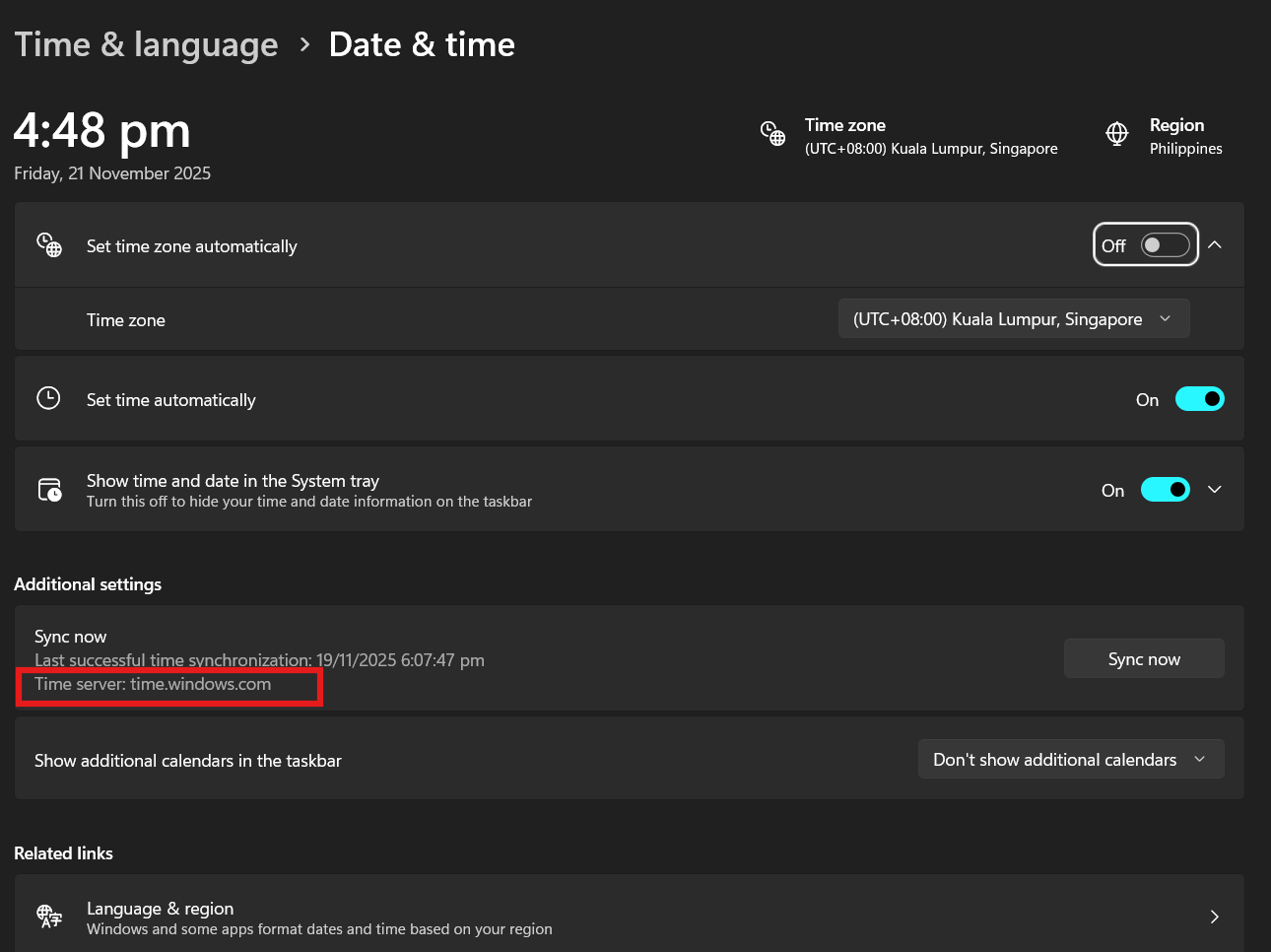

Please make sure your computer’s date and time are synced correctly — large mismatches can cause certificate and cache errors that prevent assets from loading.
