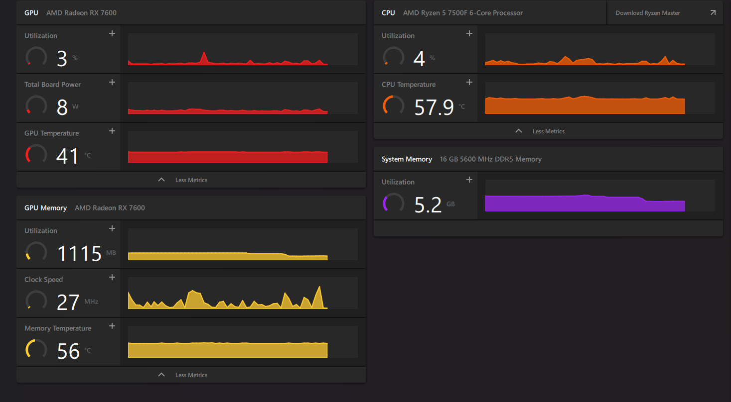

Hello, thank you for your reply.
I have followed all the instructions you mentioned and attached a photo. After formatting the computer, I only ran D5 Render, and all drivers for the components are updated to the latest version.
However, I encountered the following error message, and the program shut down:
“Out of video memory trying to allocate a rendering resource. Make sure your video card has the minimum required memory, try lowering the resolution and/or closing other applications that are running. Exiting…”

Based on your comparisons, I presume that the main problem with your AMD device is insufficient memory(RAM). Could you please show me this page of your AMD device when running that scene file?
In this case, I’d like to suggest you clean up your computer or set up the virtual memory. How to view and optimize memory usage? | User Manual (d5render.com)
