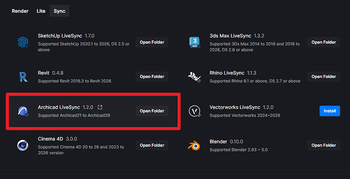

Do you have any images or screenshots comparing how it looks in ArchiCAD vs in D5 Render? Additionally, if you can send us these files for testing, that would help us identify the issue and how we can improve it. :saluting_face:
Before sending us the files, we recommend the following:
  1. Ensure you are using the latest ArchiCAD LiveSync plugin version (e.g., v1.2.0.0002 or newer).
  2. Check if the model uses NURBS or high-resolution meshes in ArchiCAD, these may be downsampled during sync.
  3. Try exporting the problematic furniture as an FBX or OBJ from ArchiCAD and importing directly into D5 (bypassing LiveSync) to see if the issue persists.
