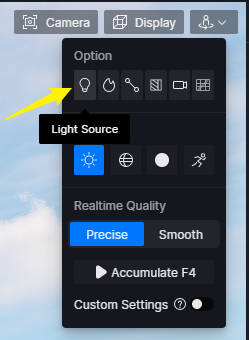

Is there a solution to this? I want to hide these icons also. So that I can record my screen .
Hi @paulruzgal
Try to disable this icon.
Light Source Icon
