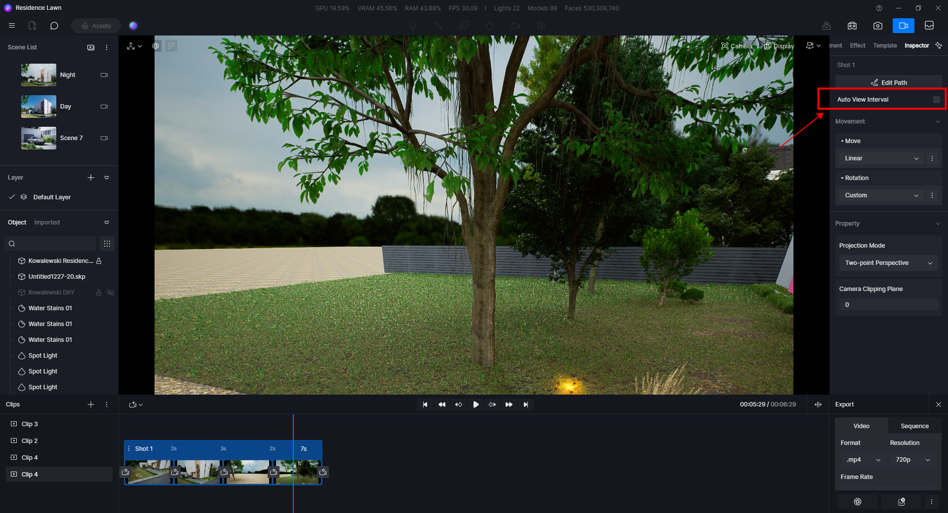

having trouble setting equal time duration for each frame… is there a way to make it uniform then whatever is the excess will be on my last frame.
for example : i have TOTAL DURATIOn 14secs…
can i set each frame to 3s 3s 3s 3s and 2s as my last frame. = 14seconds in total

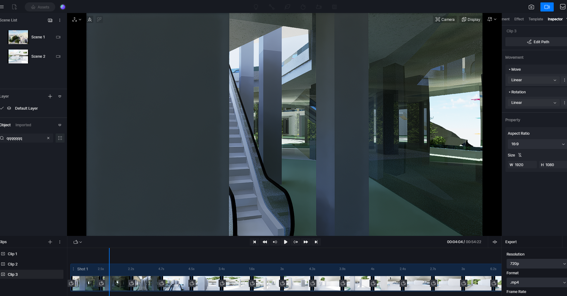

for now it seems random even if i modify individually…
or i am not doing it correctly… im sure something is off…

please select the shot bar first, if you do not tick the Auto View Interval button, you can set each shot to be 3s,3s,3s,3s, and 2s.
