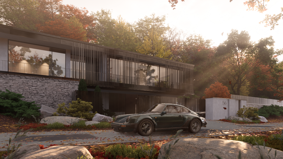

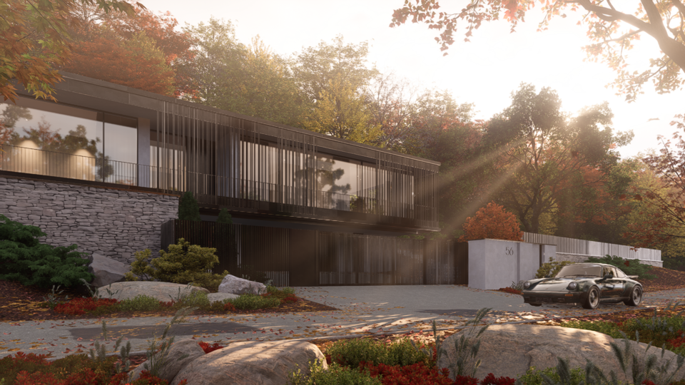

Hi everyone! I’ve run into the following issue — blurry animation quality. When I rendered still images, everything looked great. Then I decided to make animations, rendered a .png sequence in 1080p at 60fps, and got what you can see in screenshots 1 and 2 — a blurry car with no clear reflections, and the wheels look like complete mush.

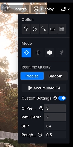

I’m using version 2.11, SR is disabled in the widgets, and I’ve attached screenshots of my settings. Could someone please tell me what I’m doing wrong?

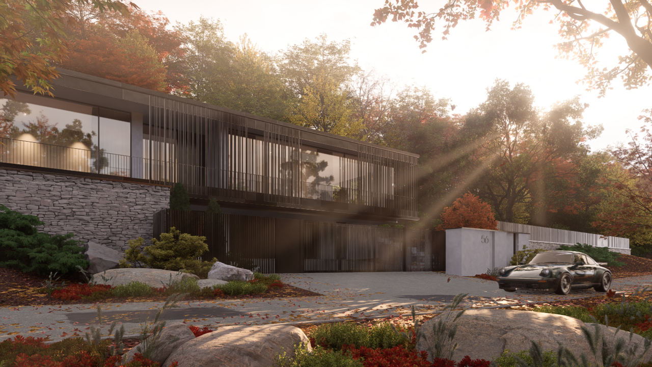

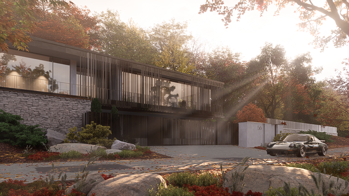

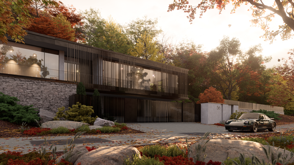

Yesterday I was experimenting with different resolutions — rendered in 1080p (scr1) and 2K (scr2), but the result is still blurry. Then I decided to render a still image in 1080p (scr3), and it looks much better than the animation. Basically, I’ve tried everything. My PC can’t handle 4K animation, and I don’t really need it anyway — 2K should be perfectly sharp.
Is it normal that an animation looks worse than a still render at the same resolution?

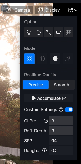

My settings:

  • Does disabling Super Resolution, FPS Booster, and Supersampling improve the quality?

Does it make afffect on render quality? I thought it was to optimize work in the viewport
Not as significant as the D5 SR Widget, and there are some known issues which, in some cases, if some of these options are enabled, it will result into something unnatural.
