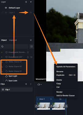

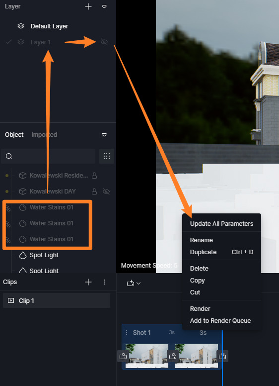

I just saw the video that you shared. I would like to you to try this method. You can use the layer management function to control object visibility across scenes:
  • Place the objects you want to hide in a specific layer, then hide this layer in the target scene. When a layer is hidden, all objects in the layer will be hidden immediately, and any new objects added to the layer will also be hidden
  • Check if the layer containing the hidden objects is accidentally set to visible in the next scene (video).
