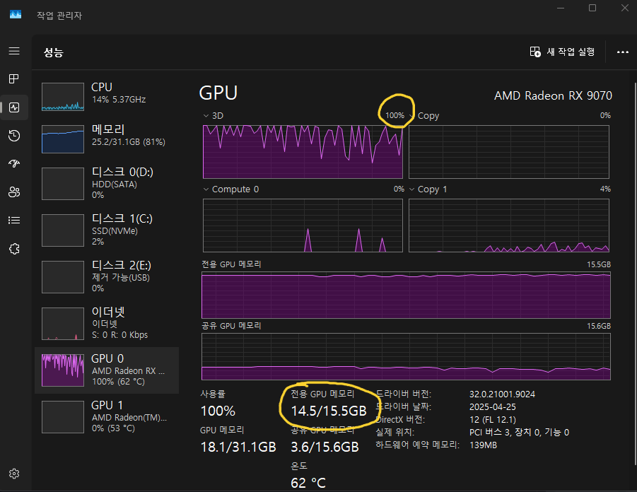

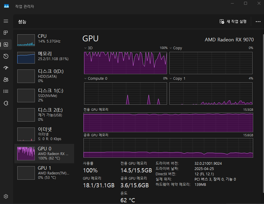

Is this file perhaps heavy? Based on the images that you have sent, your GPU numbers are quite maxed out, which may have been caused by heavy assets.

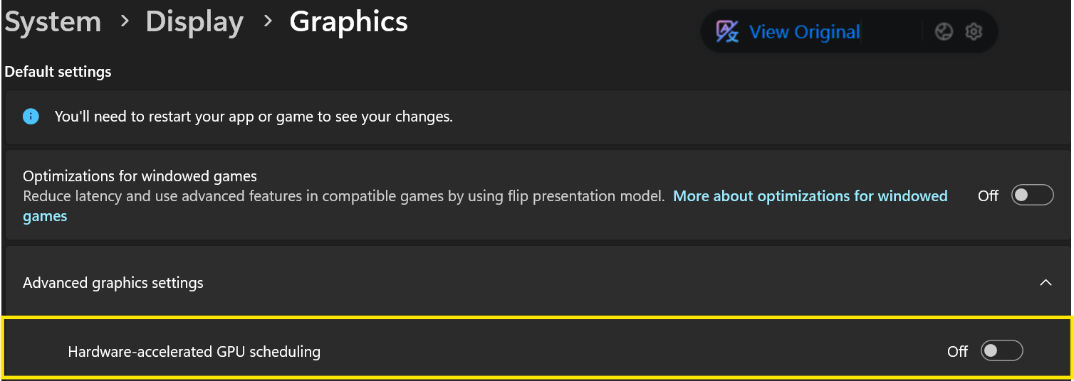

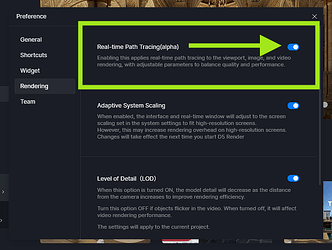

  • Temporarily Disable Path Tracing and try to render again if the crash still occurs. Path Tracing will increase GPU or VRAM Consumption since it will have a more accurate calculation of light.
  • Disable Hardware-accelerated GPU Scheduling.
When I tried it with the method suggested above
My computer stops without turning off
