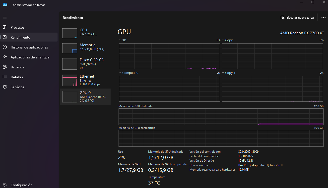

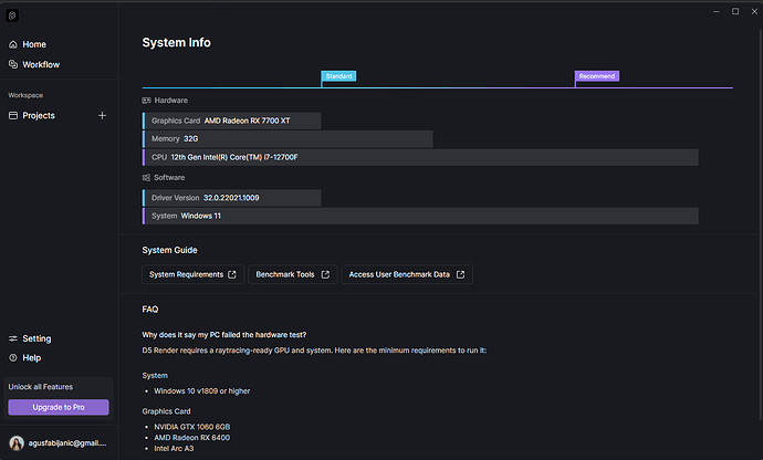

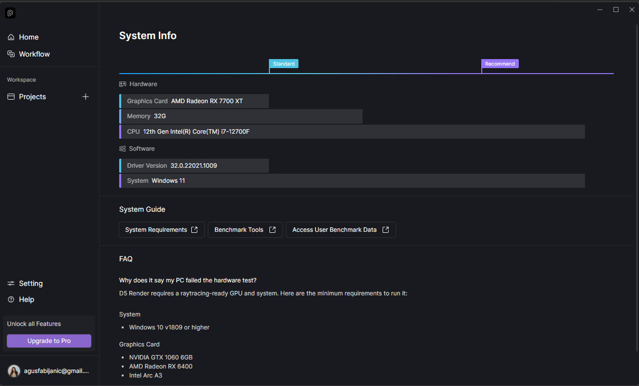

Datos del equipo:
  • Sistema operativo: Windows 11 Pro (versión 25H2, compilación 26020.7019)
  • Procesador: Intel Core i7-12700F (12.ª generación, 2,10 GHz)

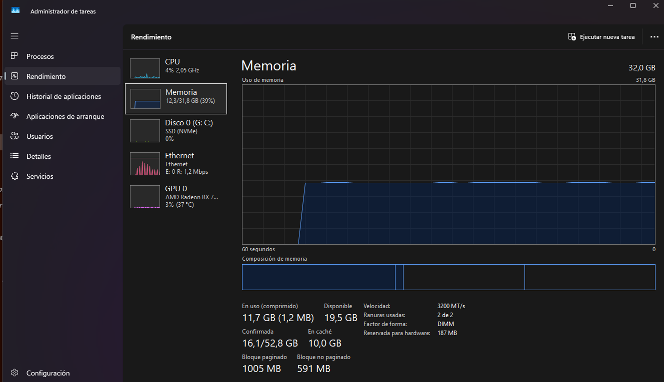

  • Memoria RAM: 32 GB (3200 MHz)
  • Tarjeta gráfica: AMD Radeon RX 7700 XT (12 GB VRAM)
  • Almacenamiento: SSD de 932 GB (685 GB usados)
  • Tipo de sistema: 64 bits, procesador basado en x64
  • Versión de renderizado D5: V 2.11.1
Adjunto imágenes de mi sistema

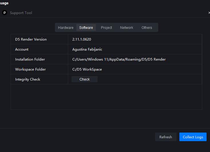

  • How about your D5 Render Version? Are you currently in 2.11.1.0620? With the version that worked before, can you recall which version?

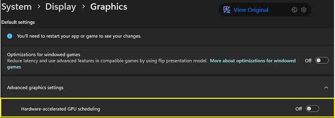

  • Try to disable GPU Hardware Scheduling.

We currently have an issue with AMD Drivers Version 25.10.1, can you confirm if this is the current version you’re running?
If you’re running that Driver Version, please do the following:
Solution:
  1. First, close D5, then delete the files in the following two directories. If you can’t delete certain files, simply click “Skip.”
    • %AppData%\Local\AMD\DxcCache
    • %AppData%\Local\AMD\DxCache
  2. Roll back the driver:
We’re also reaching out to AMD directly to address this issue. We sincerely apologize for any inconvenience this may cause.
si, tengo la version 2.11.1.0620
ya desahabilite la programacion de hardware de la gpu pero sigue cerrandoce ni bien lo inicio

Can you screen record a video showing the whole issue? And we may also need to collect your log files.
