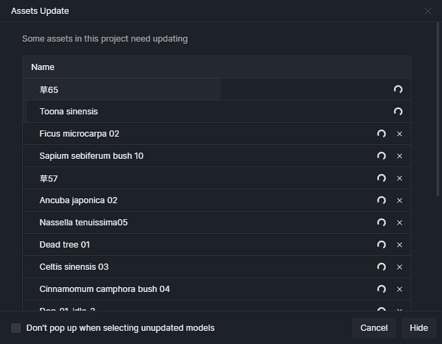

Hi there,
If these assets are from the D5 Asset Library and its quite taking some space. I do suggest deleting the .pak (f2 folder) which is usually located in this directory:
C:\D5 WorkSpace\content\Paks
Deleting this folder may free up space, but you might need to update the assets used in your project files once you open them again after deleting the f2 folder.
Let me know if this helps. Thank you.
