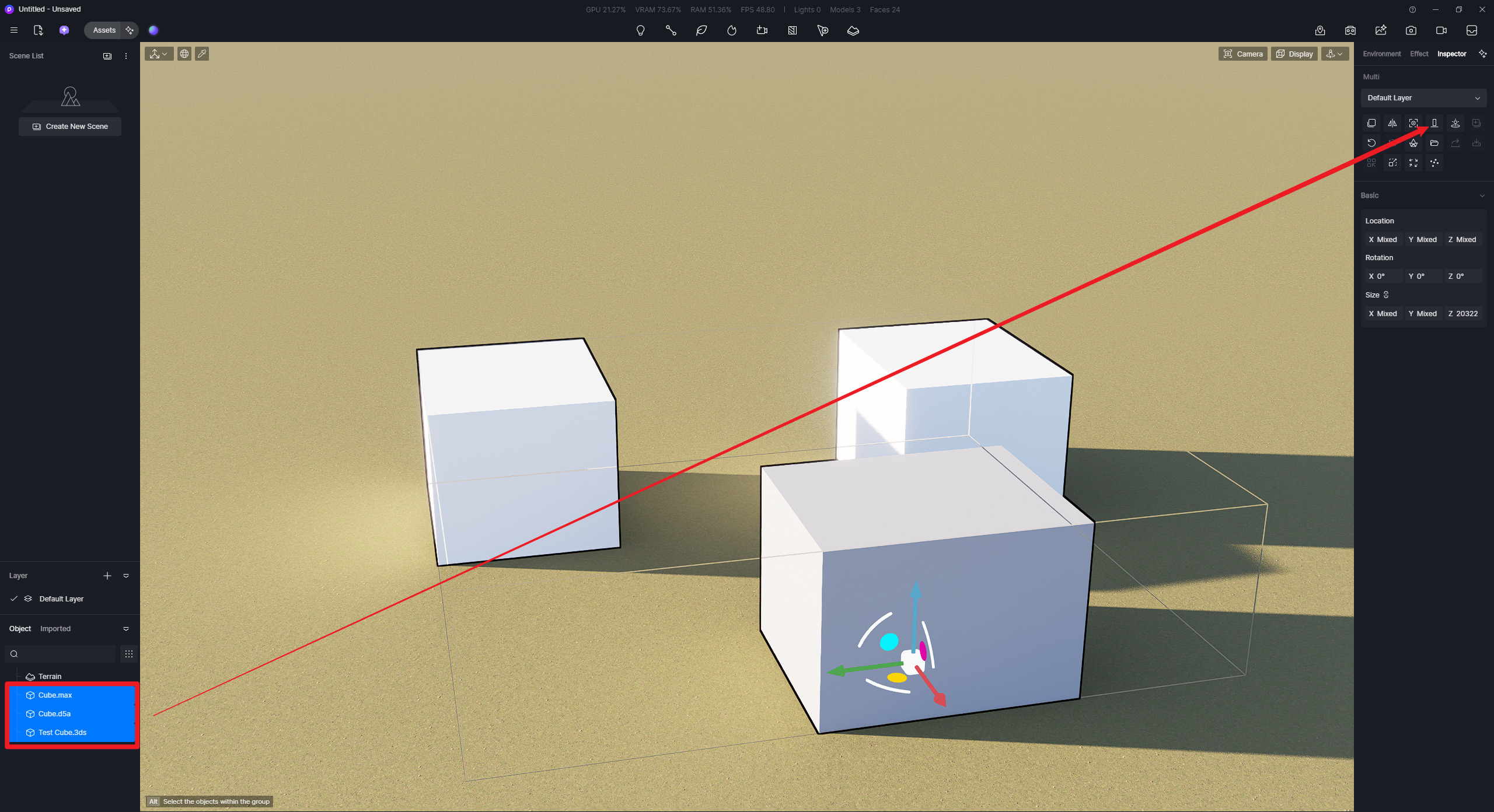

Hi @charles.collin.2
Try selecting the objects, the Align tool can be used after that.

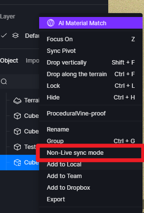

  • As for the object brough to D5 via Livesync, please switch to Non-Livesync mode to activate Align
