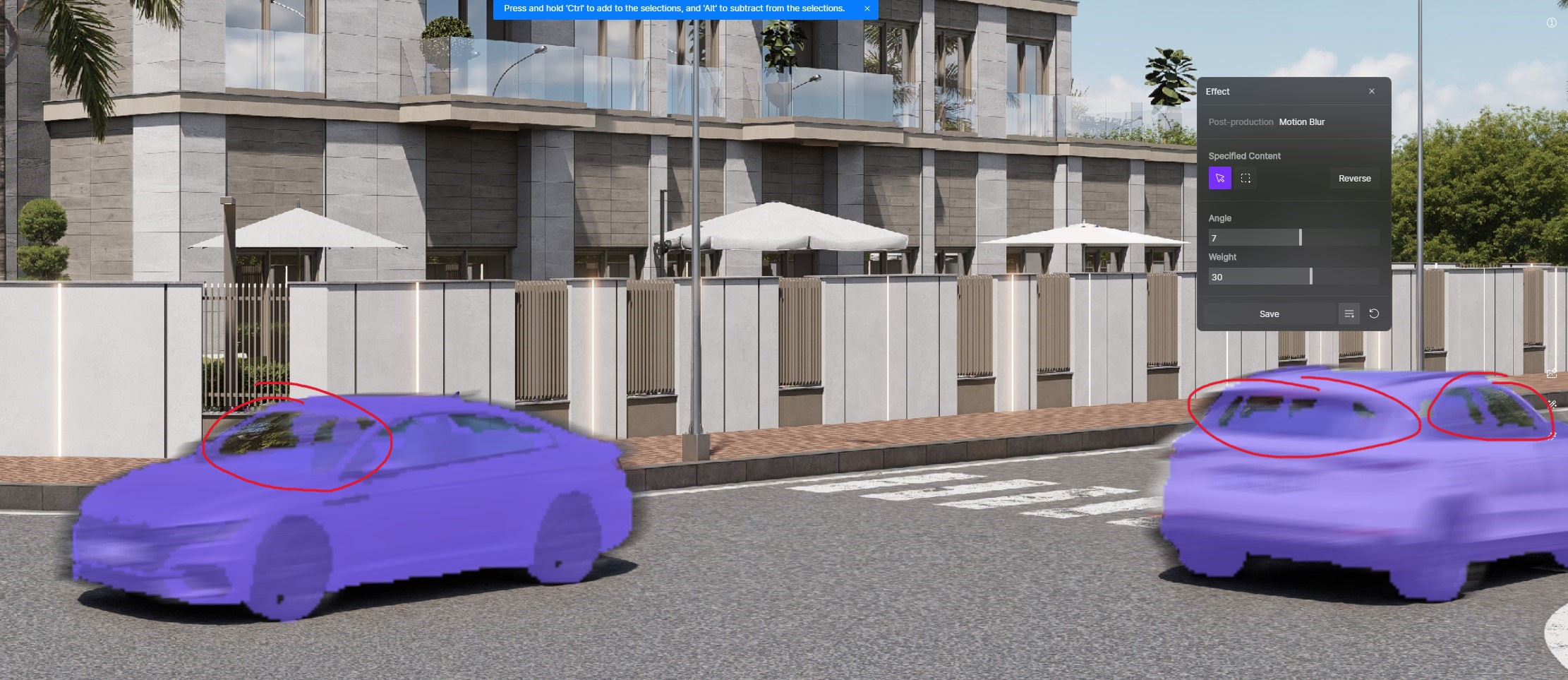

I can’t select the car windows on my own ready car models in AI Tool. Motion Blur needs to be active on the windows to create them cleanly, it doesn’t detect the windows as a material.
Hi @Furkan
Thanks for pointing this out, I’ve reported this issue further to our team to improve it.
Hi @Furkan
Our AI channel graph currently inherits from the material channel graph and lacks a dedicated transparent channel. This means we can’t distinguish transparent objects within the current process. This requirement has been noted and will be improved in subsequent release.
  • As for the workaround, it’s best to adjust the transparency of the windows to improved selection.
