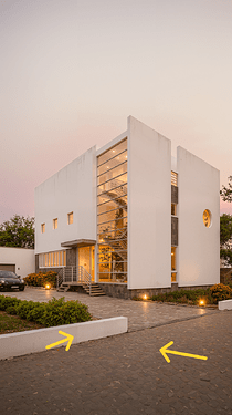

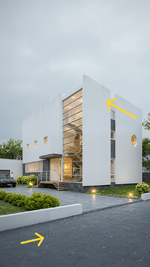

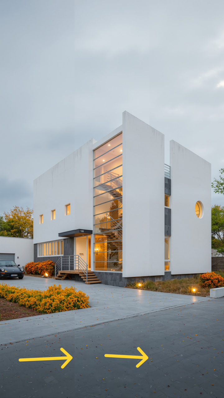

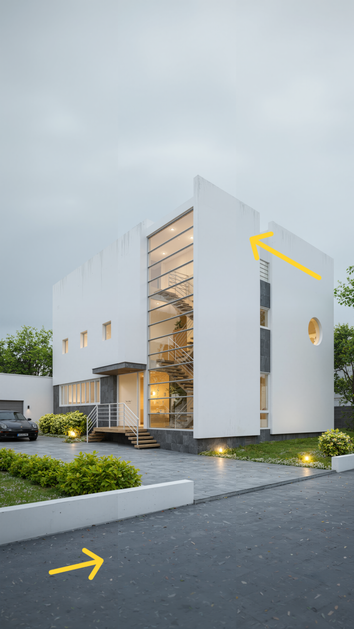

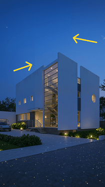

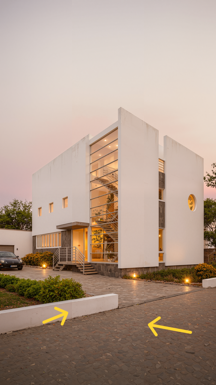

When I use the AI style tranfer there is a visible line in the image, it seems that there are two, in the image below three, slight different images next to each other. What can I do about this?
When you zoom in on the picture you can see that the picture is divided in three equel parts, its seems that the parts on the outside are the same but the middle one is different.

I apologize for the inconvenience. Indeed I can see the 3 lines separating the images. Just to clarify:
Can you share with me the detailed process? Which Stylized option did you choose? Or was it under the Realistic category, and which option was used?

So the problem occurs only with the extra camera for social media size. The normal camera doesnt have that problem. It happens with the realistic category, I tried the Spring and Autumn ones. Both have the lines in the image.
It happens also with other files, just with the 9:16 format.

Thank you for giving this information. We were able to replicate the issue, and it is only evident in Style Transfer - Realistic - Any of the effects. We will be working on a fix for this.
