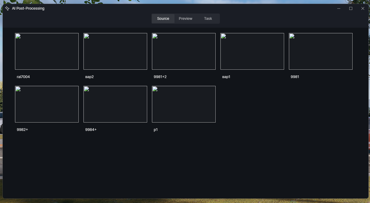

After updating to the 2.11 version, the “AI Post Processing” feature has completely stopped working. The rendered file doesn’t open in the window and is not clickable at all.
Could you please help me solve this issue?

Hi Ryann-Z, yep, I do. I have downgraded to 2.10 and it perfectly works.

Hi Assem,You can continue to use version 2.11 and save the files in the local path. Our development team is currently working on this issue.
Hi,this issue has been resolved in the latest version. You can upgrade to version 2.11.0.0603 using the D5 launcher.
