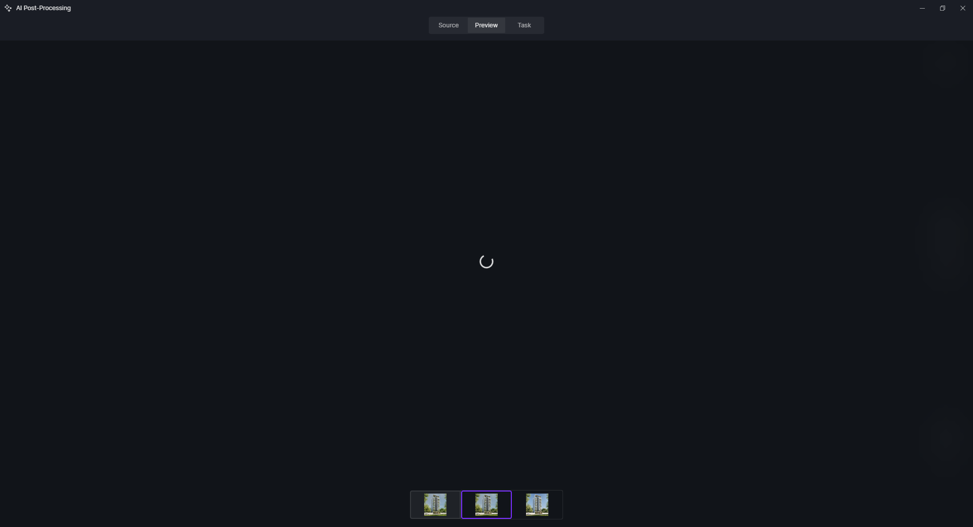

Have you tried using another Network (Cellular Data) or VPN and see if the issue is gone?
no , I tried with lan connection. but image appears 8-10 minutes after 100% processing.
