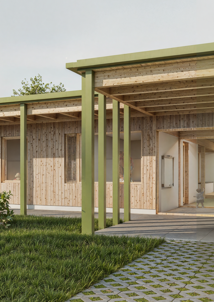

I’m curious about how to create super realistic renderings in D5 with the help of AI.
Here are three examples:
Original (No AI Enhancement)
AI Enhancement Weight: 0.7
AI Enhancement Weight: 0.9
I think that the third rendering with a 0.9 enhancement weight looks more realistic, especially with the improved shadows. However, the textures change significantly.
Is it possible to use AI in a way that preserves the original textures while enhancing contrast, shadows, and other effects?

The issue I’m facing is that I select different Enhancement Weights for various parts, but in the end, the AI applies the same Enhancement Weight to the entire picture, rather than just the selected areas.
I’m not sure if I’m doing something wrong. Are there any good tutorials available on this topic?
