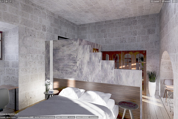

Hello, I have problems with the new update, before this new version, the program ran normally, however, when opening after updating, this happens, my graphics card is a GTX 1660, can someone help me?
Don’t worry, it happened to me too, but the rendering does it well, it happens to some old files made with other versions, if you don’t want to see these shades of colors you have to remove the quote mark in super resolution.
Hello. Apart from trying to turn off SR, you can also check if the version of your graphics card driver is too old. If it is too old, update to a newer version.
