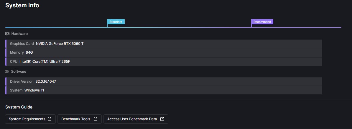

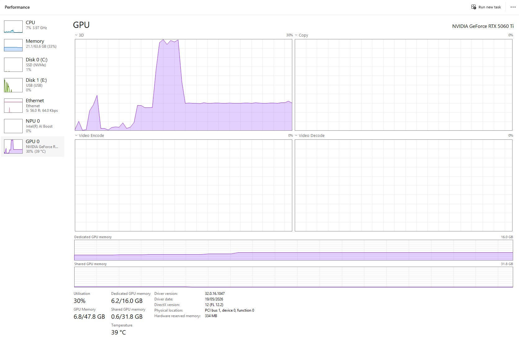

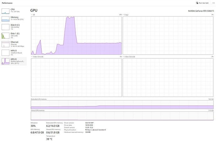

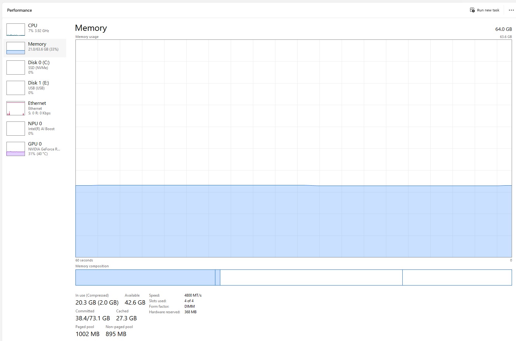

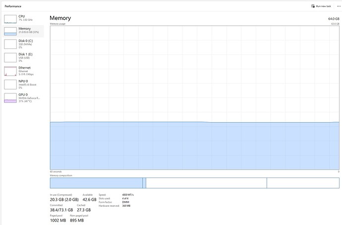

Hi, Thanks for the reply, I have attached the screen shots requested. I haven’t had a crash issue yet but will send when I do as I have not used D5 yet today.
The models are not missing, it’s parts of the imported model, but once I re-import they are fine. I feel these issues are related to Graphics card driver updates from Nvidia as I have never had these issues in all the years I’ve been using D5 pro.
Regards,
George

Additionally, we received many reports of crashes, and the common configuration is the latest NVIDIA Driver 610.47. Can you please generate a log file for us? You may send it to me privately here in the Forum.
  • After generating the log files, you can try to revert to NVIDIA’s previous version.
