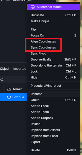

Hi @visualplus
Just to clarify, when models are exported to D5A and are placed in D5 Render, they are usually placed manually, which makes you decide where the object is going to be placed. Do you perhaps mean that this model was just synced via the Livesync Tool?
  • Were you able to use any of the following features to ensure the coordinates are the same?
  • Which version of the plug-in are you currently using?
  • You may also try checking the Coordinate Switch Method.

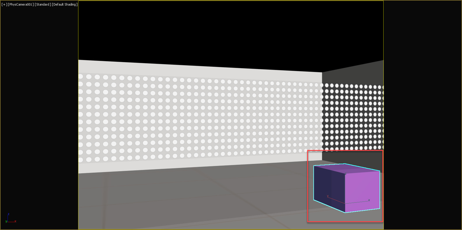

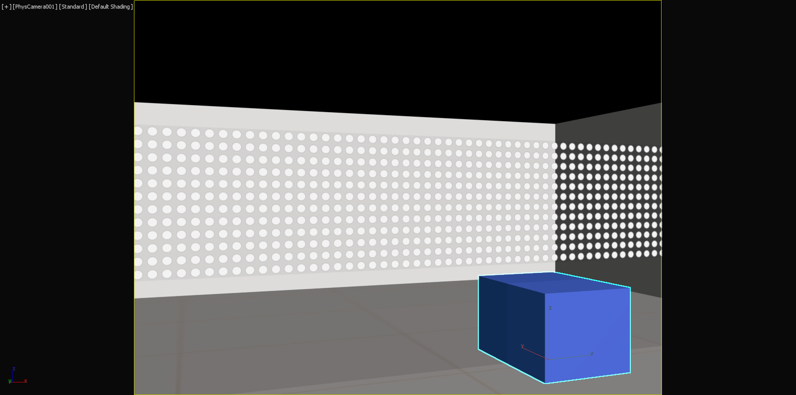

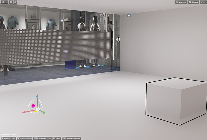

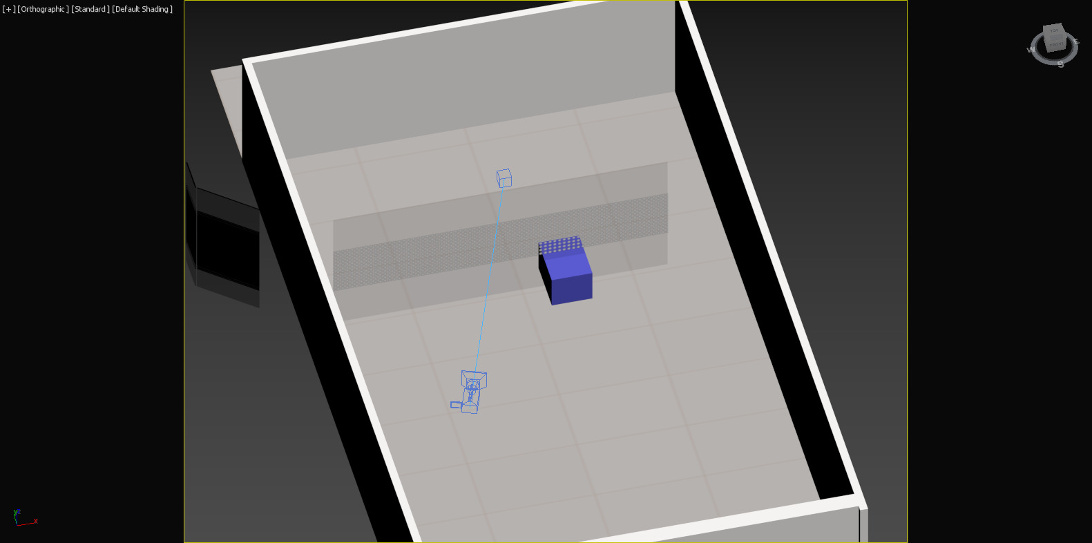

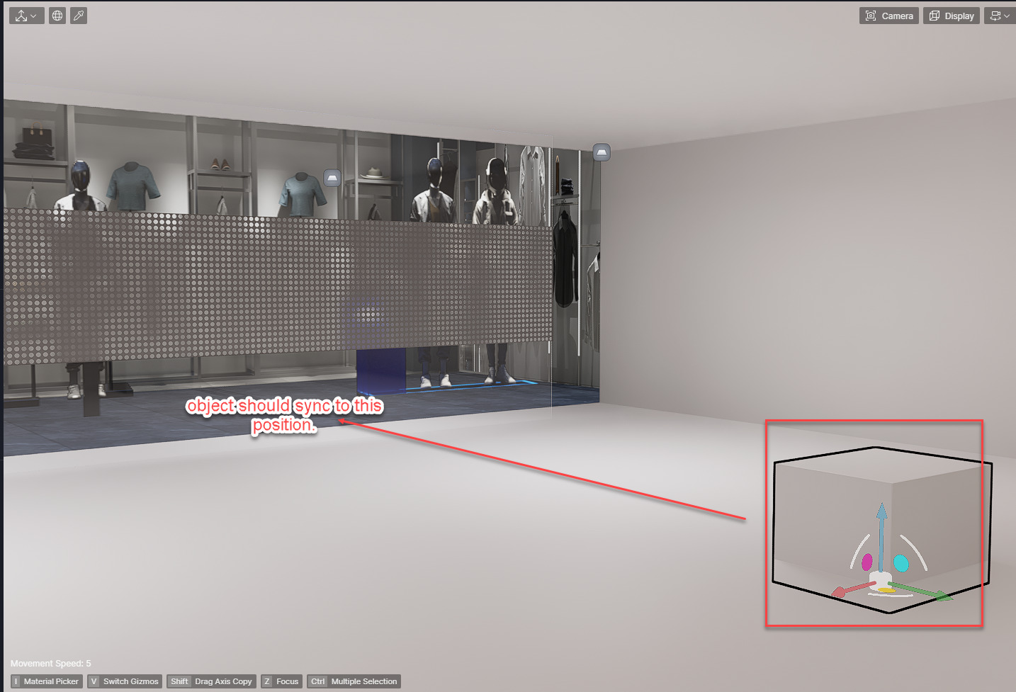

i have installed livesync, after done suggested sync method by u . scene was rotated, so changed coordinate method to y/-y and scene matched. later i exported box again but that box is still not in position after sync coordinate. weird . im using 3dsmax 2020, is there any issue with this version.
max scene
d5 scene , box is away from glass
thanks

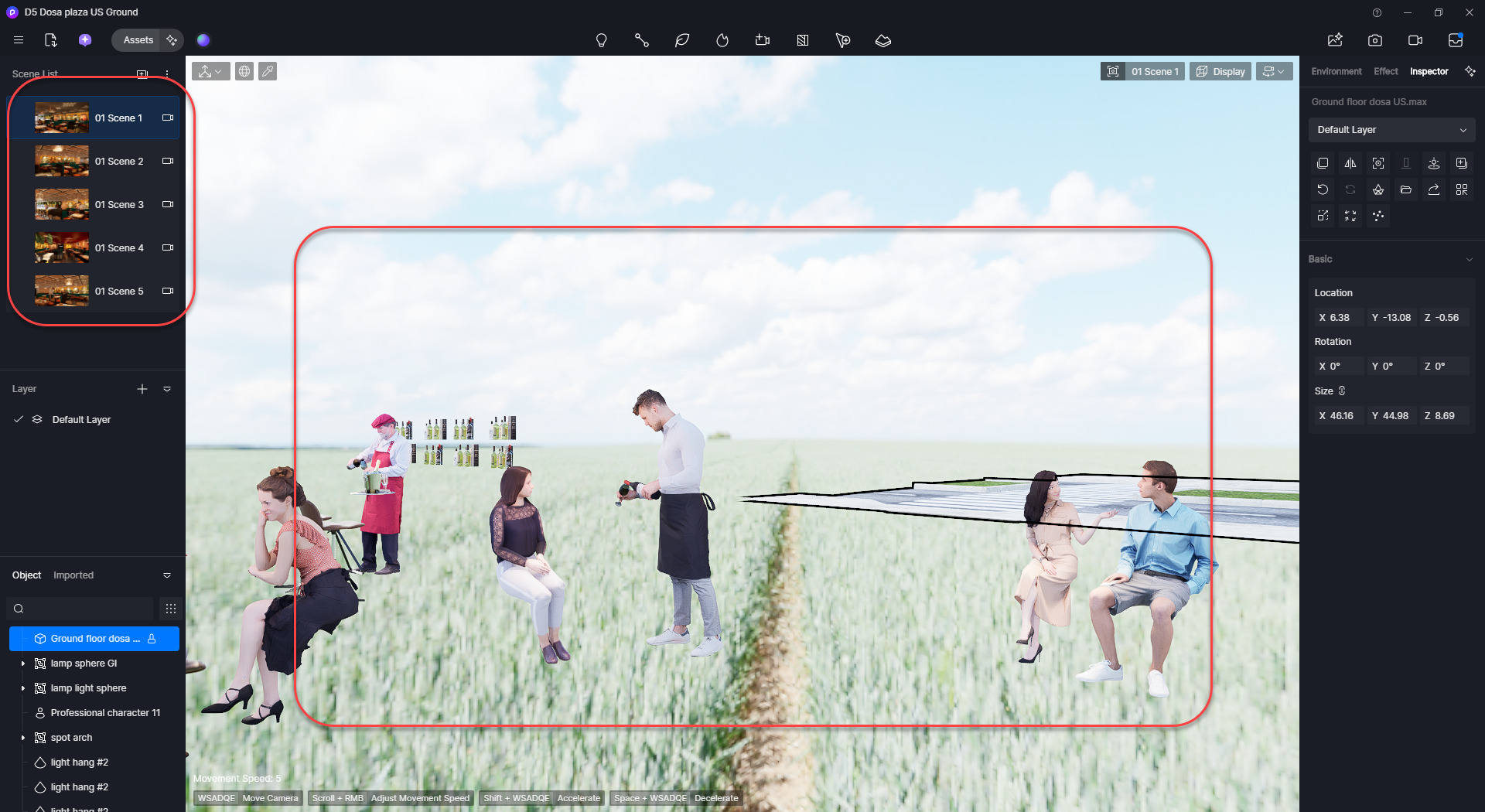

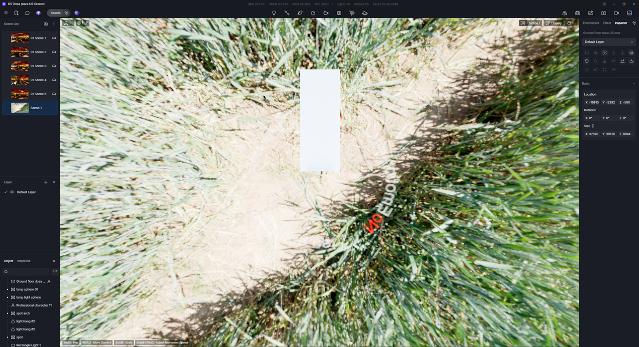

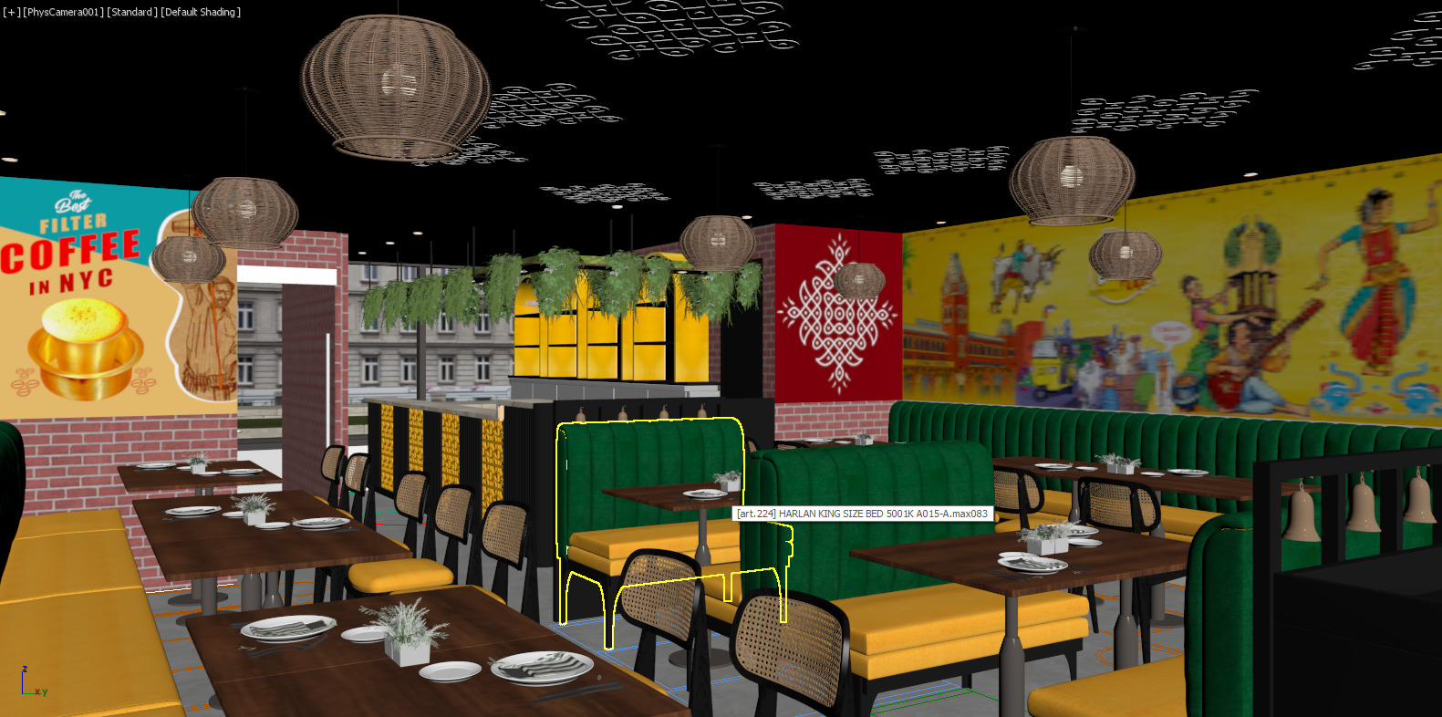

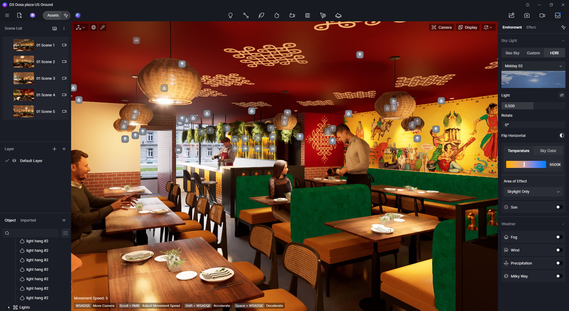

ohh god its happening in all my projects. actual scene get shifted some where else , d5 assets stays still at place . sharing shots
3dsmax scene
d5 scene

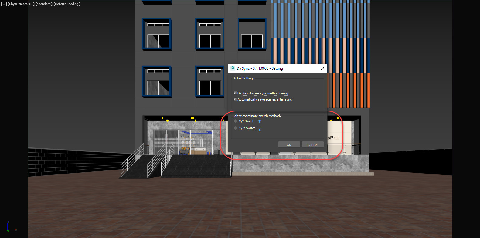

i strongly think D5 normal sync messing with x/y switch method (all work done in same method). even livesync also not helping in this scenario.
after switching y/-y switch to both max and D5 all back to normal, why this x/y messed up with scenes.
please find what cause ASAP. everything was fine few days back.
thanks

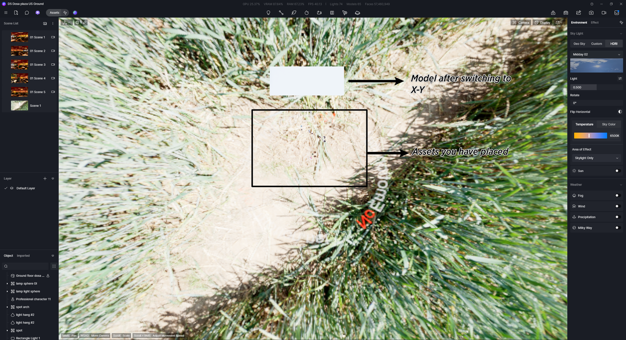

Hi @visualplus
I just tested your 3ds Max with your D5 File.
When Livesync is activated, it utilizes a specific coordinate system for synchronization. By default, Livesync is set to follow the host application’s X-Y coordinate plane (meaning the plane defined by the X and Y axes is typically the ground plane).
  • It appears that during your recent editing sessions (placing assets and materials), you might have been working with a setup or file configuration that uses a Y-Y coordinate plane, which is completely under expectation since the assets you have placed are based on the Y-Y model positioning, hence, activating the plug-in again without modifying its settings will yield a different placement.
  • I don’t think this is a concern or a bug since it is just a matter of remembering which coordinate system was used when you were first syncing the model.

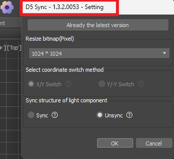

hi,

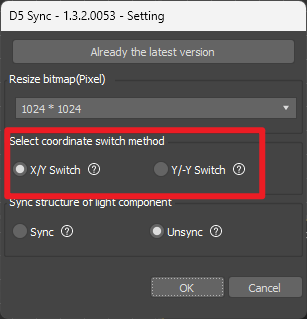

from the day i work with d5, i never fiddle with method. using recomm. default X/y for all projects.
i strongly believe there some settings altered internally. is there any config file where x/y method is configured while we work in D5. i think that might got switched to y/-y for default.
today i started new project and as u see there no method ticked , all is in place so far.
thanks.

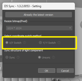

Hi @visualplus
I think this stems from the difference between D5 Livesync vs D5 Sync; you did mention that you were using D5 Sync ever since starting with our software.
  • D5 Sync: does not have any default activation on these settings compared to D5 Livesync (which I suggested for you to use).
  • D5 Livesync: By default, the plug-in uses the X-Y coordinates, and currently, there is no setting to change the default. Although I may need to confirm this with our team.

and one more thing when i export object from same file as d5a to import as option. that import placed on some other place even after ciicked sync co-or. i think export is taking x/y co-or in export. something is going wrong. before everything was perfect with same D5 sync.
