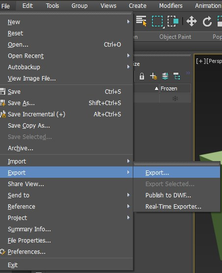

I tried exporting the scene to d5 format but 3ds max crashes on export. I tried blank scene with a box and it crashes again.

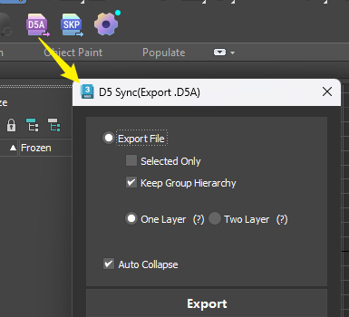

  • As for your other question, the most efficient way is through the Plug-in.
ahhh, ok, so I used Export from FILE menu, once I used export from the D5 menu it worked fine on sample file but main file just crashed after some work, no d5 file left (definately better as it reached 100% export before crashing). Email sent
