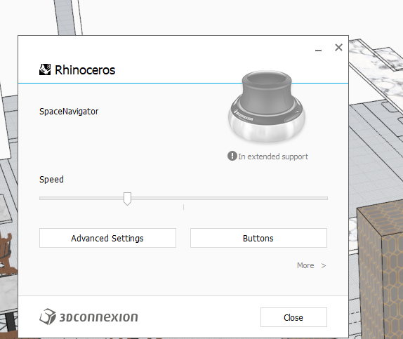

Inside Rhino, I can open 3dConnextino property by clicking the button on the mouse, and it seems it is connected to the software. However, it won’t work to navigate in the modeling software.
Calibrate didn’t work, either.
